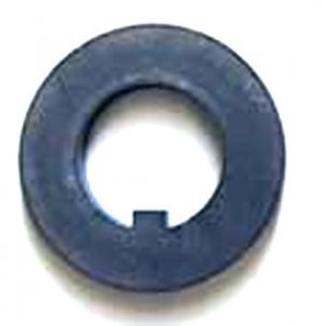

    Hey all, quick question that hopefully someone can answer. I changed my rear diff oil yesterday and found something stuck to the magnet on the drain plug that has me slightly concerned. Aside from the usual metallic grime (and one small shaving), I found what appears to be a small conical keyed washer, maybe 3/8" (or 9-10mm) in diameter. I'm not sure it was originally cone-shaped, especially since it seems that it was loose in my rear diff.
    I lost it before I was able to take a picture, so I apologize for not being able to provide more information. Attached is a picture of a flat keyed washer. Does anyone have an idea of where it came from, or if it should be cause for concern?

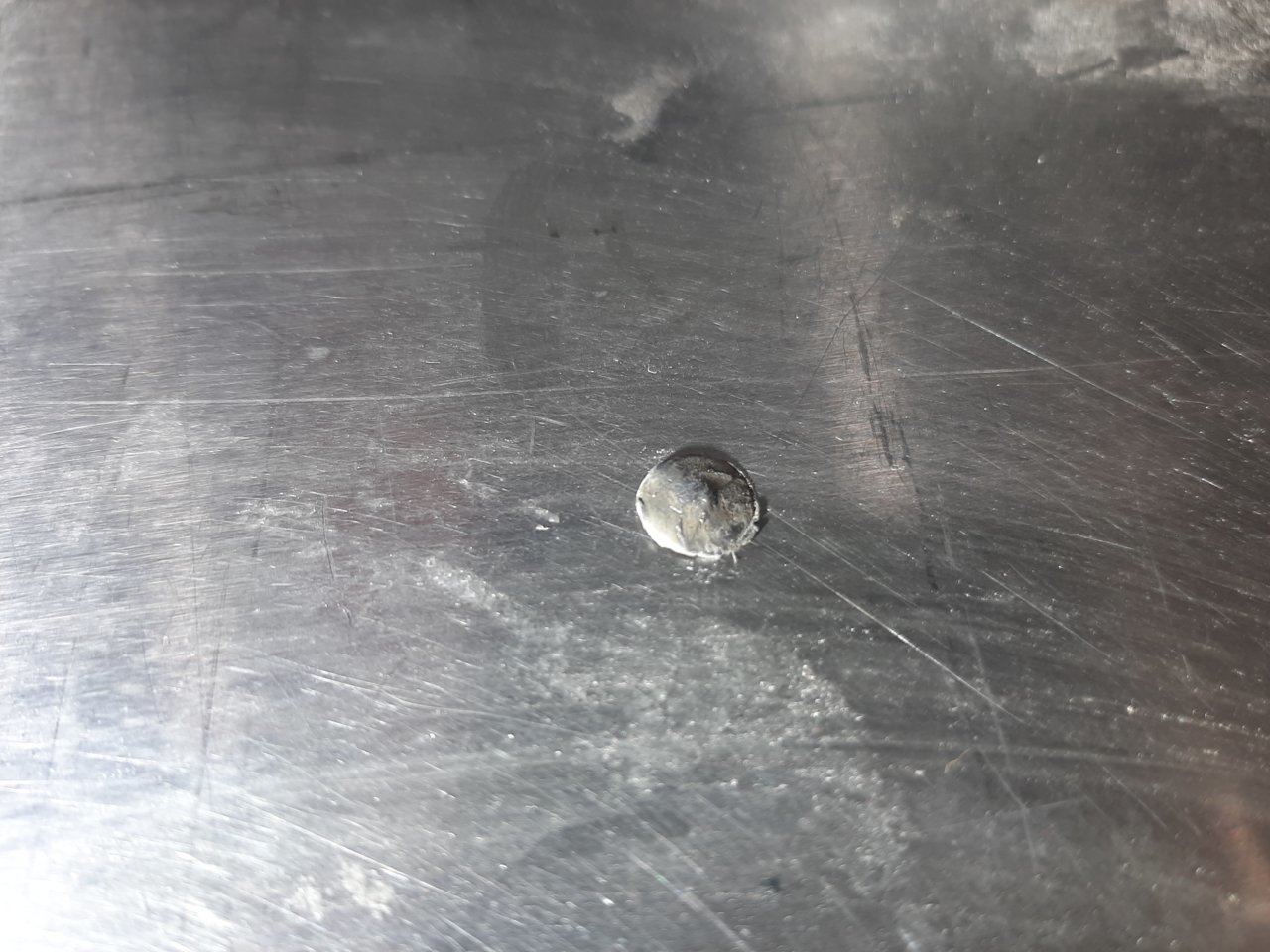

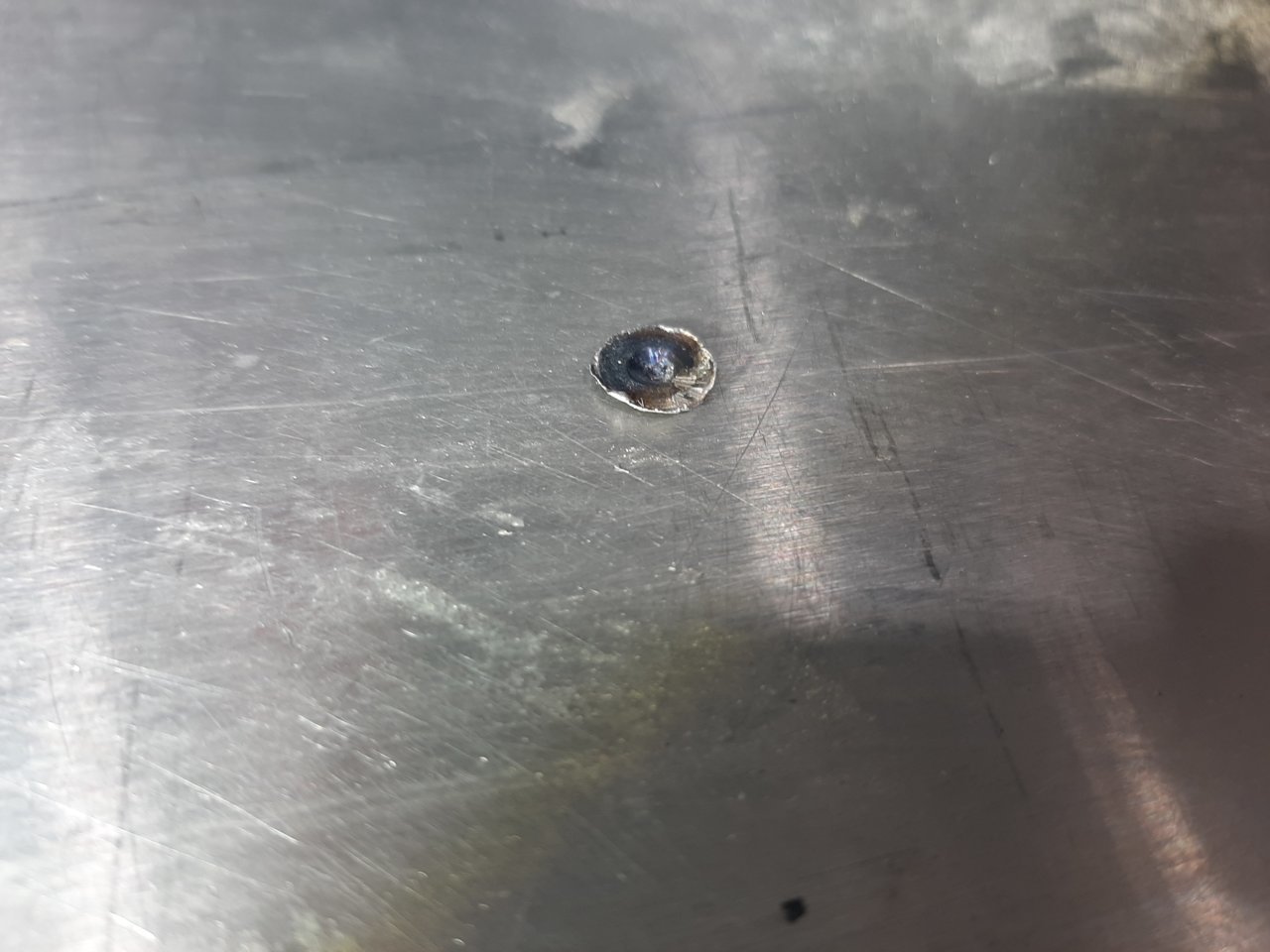

    Start calling me Hawkeye. This is what came out of the diff.

    That looks like the back side of what comes out when you drill a hole.
    It might have hung onto the threaded area for a while then broken off. It doesn't seem to have been through your gears, also doesn't look like bearing material.
    You are probably ok, maybe change the oil a little sooner than normal just to check up and have piece of mind.

    Clean it off little and take a better picture, I can see what look to be heat from a drill bit showing through the backside. The 3 dark spots.

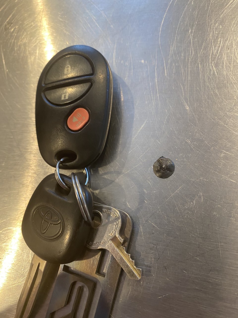

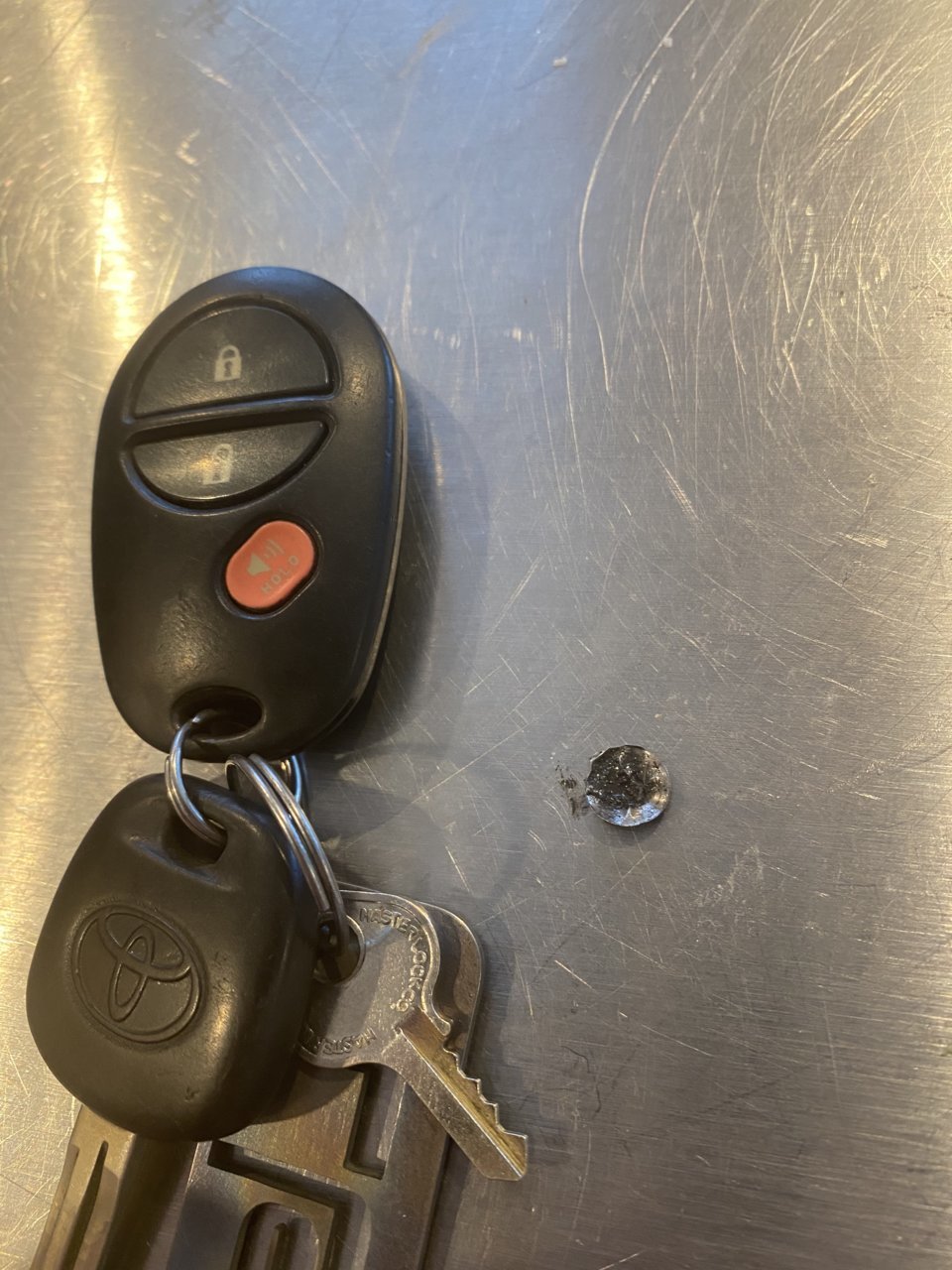

    This is from a piece of 16ga or 1/8" I think, I have a bunch of these from working on stuff in the shop.
    It was drilled fast with a spot weld bit. That's why mine has a deep center hole and lots of heat.

    That's what this looks like. Dark on one side and has a little dimple in the middle, barely broken through.
    edit: it only looks a little wrinkly because it was on the garage floor while we continued working and got stepped on, etc.
