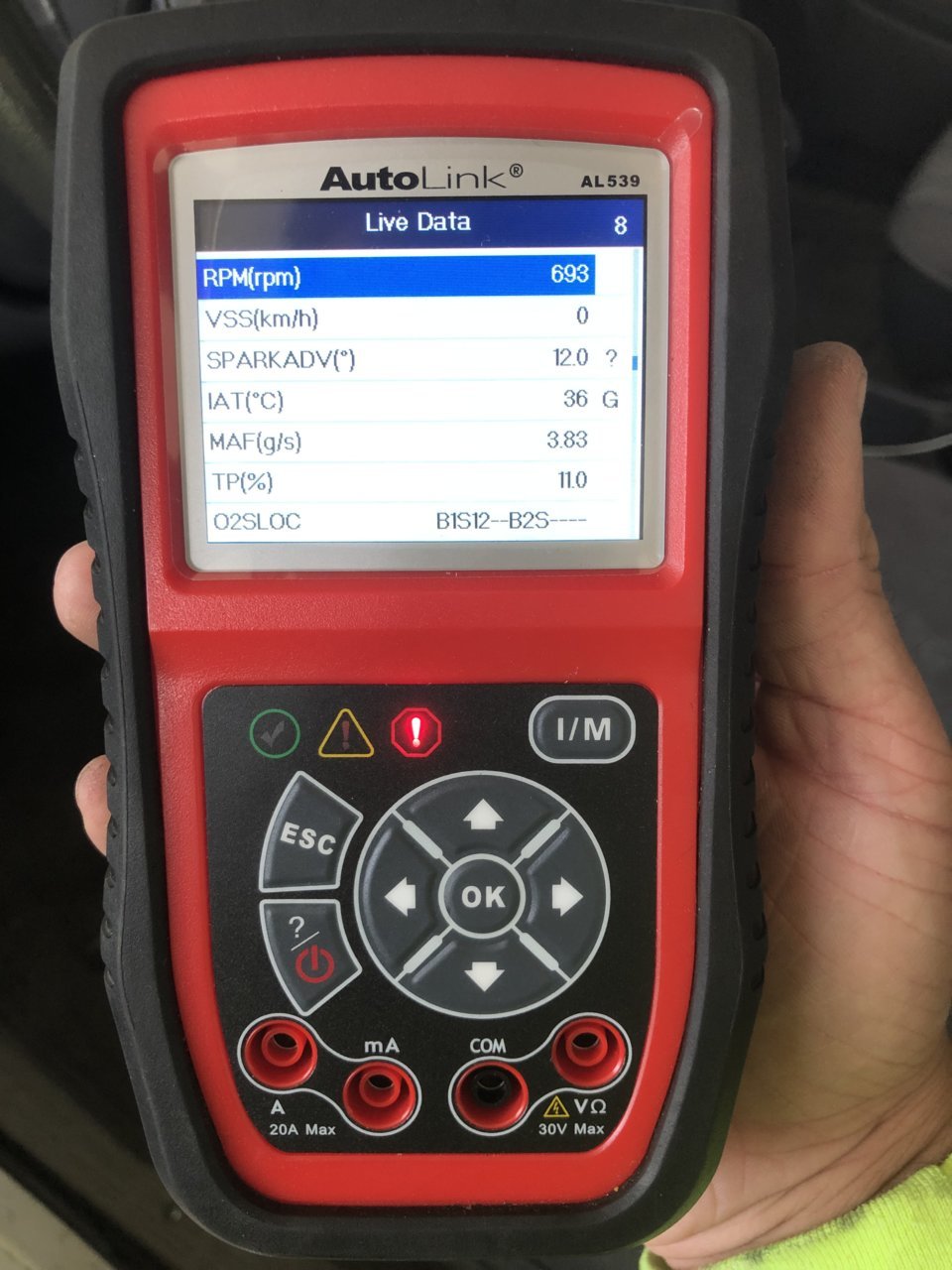

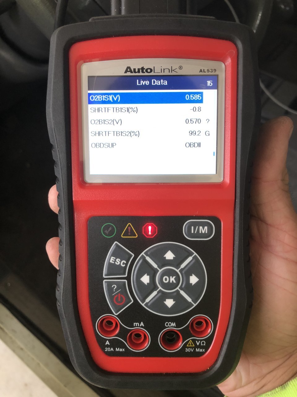

    Pictures of scan:
    Here are some live scans of the motor. These scans were taken at idle. Notice the long term fuel trim is absurdly high at 28. Should be below 10.

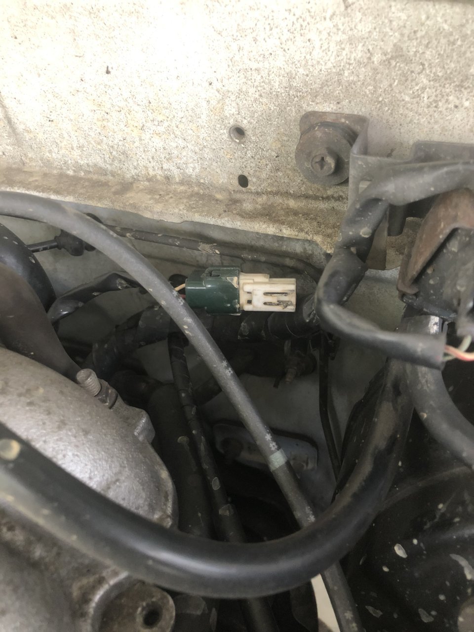

    Also here is a random plug that is sketching me out:

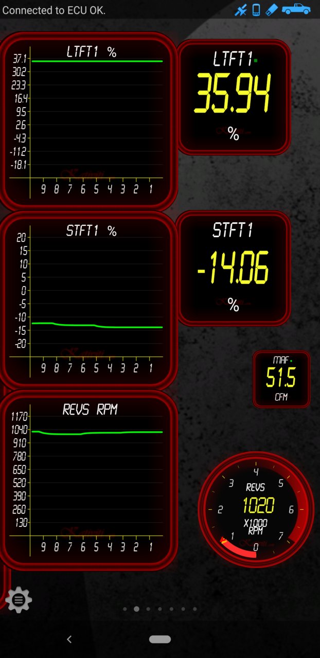

    Right up my alley, I just spent two weeks chasing mine, 2002 6cyl, 5VZ-FE engine. Your fuel trims look similar to mine. Had insane values sometimes a difference of 45%+ (!!!) at idling but they were good while accelerating. Sometimes the check engine light would go away after I filled up and use Techron fuel system treatment.
    I ended up swapping my MAF sensor twice, (I no longer trust generics, stick with Denso ) The Denso helped but still threw codes. Cleaned the throttle body with throttle body cleaner (wear gloves, that stuff is vicious) after this it started throwing P0110 Intake Air Temperature Circuit at this point, I probably messed something up here.

    I then drove it on city and freeway driving. The throttle is now extremely responsive, no lag time at all. I was able to accelerate to 80 from the on ramp with no hesitation and sustain it. I've never actually done that before since the acceleration was lagging. I kept driving for a couple of hours until I burned through a quarter tank. The light was still on so I pulled off the freeway and shut my engine off and on a few times. The check engine light cleared itself. So I hooked up my torque app to check the Fuel Trim and error codes. No codes and the trim is now normal. I'm hoping I finally fixed it, if not I'm swapping the O2 sensors next. They're original and have 265k miles on them so I figure i should do that anyway. (I've already had the fuel pump and filter and spark plugs replaced I _really_ hope the dealership didn't mess those up.)
    Hopefully this helps point you in the right direction.
    I really need to brush up on troubleshooting rather than throwing parts at it but throwing parts at it is so fun...
    The following was when it was at idle but it's good now.
