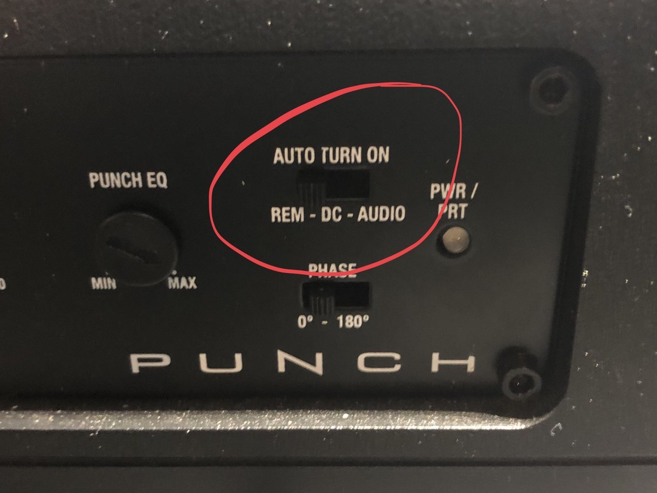

    Please provide some help.
    Truck starts fine and runs perfect.
    Scenario- I drive, come to a stop, place the truck in park, and push the button to shut the vehicle off.
    It appears to stay in accessory mode - like it would in if I shut it down in neutral. Radio stays on and I can’t lock the door wraith the fob or door handle touch sensor.
    I’m thinking the truck may not know it’s in park.
    Thoughts?
    Update/Solution: Seems that while I was doing some soundproofing I bumped the auto turn-on switch on my powered subwoofer into the “audio” input to trigger power. This was not an intuitive solution, but rather a “wtf have I done to my truck to cause this problem” thought process.
    I can’t find any documentation to resolve the “why,” but it appears that having the sub trigger off of a sensed audio input (i.e speaker input) instead of the ‘remote’ will keep the truck in accessory mode.
    I was able to repeat/cancel the error by changing the auto turn-on position.
    Goofy!

    Was having the same issue with my kicker 250.1 amp. Has the same switch,so i moved it to the 12+ (was on auto) and it fixed it! Thanks
