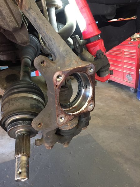

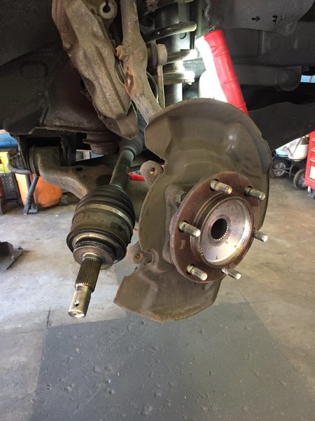

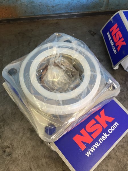

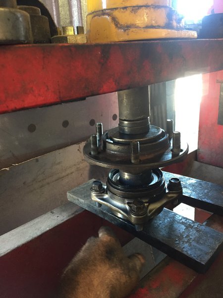

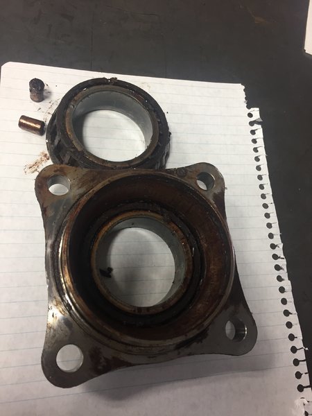

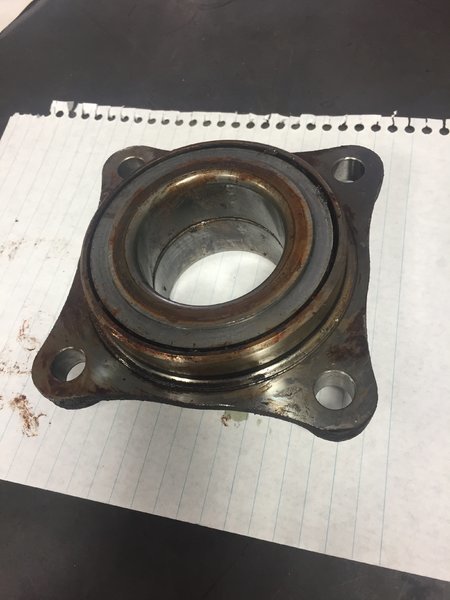

    As promised heres some pictures (descriptions below image):
    Old one out
    The plastic cage was cracked...looks rusty as well
    Heres the new one...OEM brand
    First major step was removing the nut holding the CV in place...then pull CV from the back.
    Remove dust shield and bearing/hub assembly...
    easiest way was to bolt it back on (without dust shield) and pull hub off bearing...here was my result.
    Press the hub back into the new bearing assembly and bolt it back together....its not bad unless your truck is rusty.
    Note: my cousin had a bearing (rear) in his 2006 single cab 2.7L 4x4 go out as well. Seems to be common in these trucks if you live or have lived on the east coast with them. He was living in NC.
    Thank you all who helped me figure this out...if anyone else needs help while this repair is fresh in my mind, please don't hesitate to ask...its fairly easy but takes a little bit to figure out some parts...again follow that link I provided for a good detailed breakdown of steps. Take it easy y'all.
