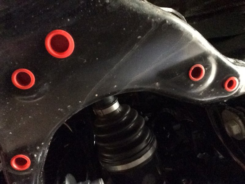

    So i actually came out to my truck when there was a crosswind parked at my shop, and as i was getting in, i heard the noise ever so slightly. Leaned down into the fender and sure enough, coke bottle howling. Went and picked up the necessary nylon plugs (bought double) and drove back up to my shop, coke bottle sound the whole way. Crawled underneath, popped em in, printed off one of the pictures from this thread, circled the plugs on them and wrote in the size, drove back down the hill with zero coke bottle howl and brought the extras i purchased along with the picture to my dealership. They were stoked. They said damn near every truck they've sold in the last few months has been in complaining about it. Theyve even done the weatherstripping trimming, but i told them this was THE FIX for that sound. Thank you so much

    Howling is gone after using the nylon plugs. Thanks everyone!

    Why would you do that when the fix is noted on the first page? It's simple. Plug 2 holes with grommets on both LCAs. Done.

    What my husband used to plug up the holes. I still have the noise. May not be the best thing to use, possibly still causing the whistle with the air flow.

    Then it's a different issue. I only plugged one of the holes and my howling went away. My noise was apparently coming from the control arm.

    You have a different issue. For those of us who had the exact 440hz howl in the Sound clip, The hole plugs worked.

    I could see how these would still cause a whistling. I think you really want solid surface plugs.
