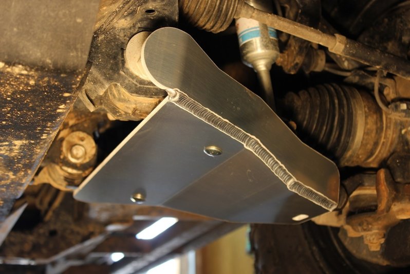

  6. Mar 24, 2016 at 6:51 PM
    #266
    silverpataco1968
    silverpataco1968 Tomorrow isn't Promised!
    Jun 28, 2015
    #158334
    708
    Eric
    Eastern PA
    2007 DCSB and 2016 DCSB TRD Off-Road
    Plenty of great products so far !
    I've got another fix!image.jpgmy LCA skids ! These are from Ricochet ! Anyone's would work If the holes have bolts through them!!
  7. Mar 24, 2016 at 7:00 PM
    #267
    silverpataco1968
    Jun 28, 2015
    #158334
    708
    Eric
    Eastern PA
    Just bought a 2016 DCSB Off Road Silver.
    Taking the skids off my 2007 tomorrow for the 16

  13. Apr 3, 2016 at 9:02 AM
    #273
    fshams
    fshams Well-Known Member
    Aug 12, 2009
    #21067
    631
    Columbus, OH
    2012 Tacoma V6 4x4 TRD/TX PRO - DCSB
    You can pickup the hole plugs at Lowe's in their hardware section next to all the screws and bolts. You just need two packs and you don't need to plug every hole. I just put one of each size on each side. Remember you just want to interrupt the air pattern flow to stop the howling noise. They will be in the specialty bins.... All Lowe's have them
    'The Hillman Group 2-Pack Hole Plugs"
    Item# 139470 11/16"
    Item# 139460 9/16"
