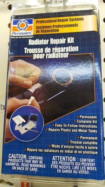

    Hers what I used to full the holes .Worked great took 15 minutes
