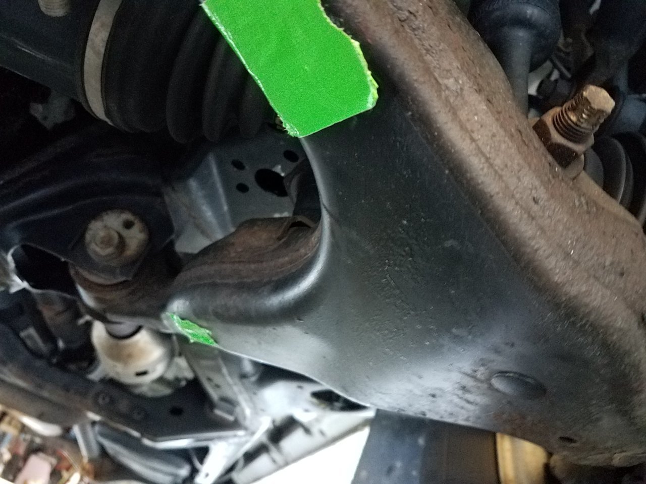

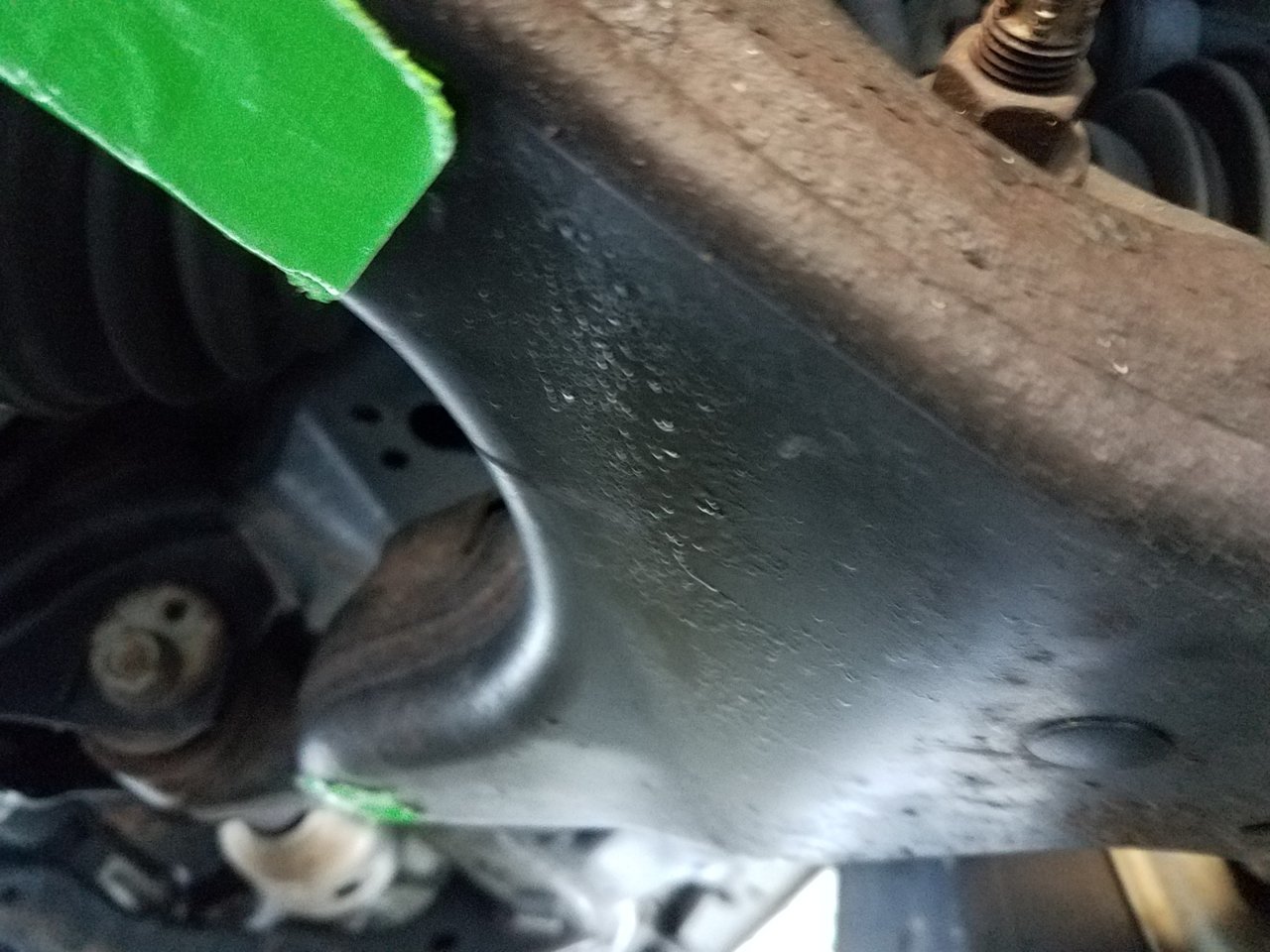

    This noise started suddenly on mine yesterday: On my truck it sounds like a light wind howl on the passenger side near the mirror. I got this truck in late June and have always been impressed at how quiet it is in the cabin, especially for a 4x4.
    The only difference in conditions is: temperature: It has been in the low-mid 50's the last few days. I did a 200 mile + round trip to Vermont this weekend on highways, back roads, mountain roads, and sketchy dirt roads (no off road, so nothing tweaked, banged, etc) in mist, light and occasionally moderate rain, but the temps never went below the mid sixties. Not a sound other than the normal road/tire and driveline noises. No howl. Parked it outside for the night. Took it out to get gas mid-day yesterday: it's howling just like the audio piece here! Gave me a sick feeling.... then I found this thread....
    Quick fixes I tried one at a time: Rolled down passenger window and others indvidually; rolled down all the windows, put them up/down in all different spots; adjust pass mirror every possible way including folding them in and out to every possible position and angle (glass and housing); ditto on the driver's even though I was positive it wasn't there; Finally: removed the antenna. No change. If I could have done it easiliy and quickly, I would have removed the passenger mirror. I even removed the bed mat. (I know, embarrasing: OCD...but I was starting to be convinced it was some dam bearing in the driveline or tranny....maybe even a tire)
    Anyway, when it stops raining again, I'll get under there and tape over the holes and report back.

    I have a 2014 SC SB that I purchased in June. 104K on the clock. The noise on mine started yesterday out of the blue. I'll be performing the "tape" fix no later than the weekend and I'll report back if it fixed it. Not definitive, but at least you'll know if it worked or not on my 2014.

    Update: I went out and applied the duct tape fix, took a test drive slowing climbing to about 55 mph, and the howl/noise is gone. It is much warmer here today: in the mid-upper 60's: much warmer than yesterday and the days previous. I can easily remove the tape and test drive it again when it hits the lower 50's again. Since the lower control arms are different on my 2014 than the 3rd gen's only the 9/16s plug will fit on the lower front hole. For the other's (which are smaller diameter and wont take a 9/16s plug, I'll stick with the duct tape or cover them with a flat layer of black 3M body putty. Note the small drain hole at the very end of the LCA.
    What's amazing to me is that even though the two generations have completely different designs for the lower control arms, and different sized holes, both have the same noise issue and this fix cures the problem on both.
