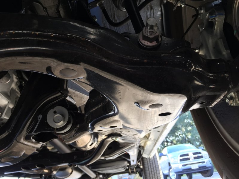

    *********UPDATE**********
    I moved the plugs to the front two holes. They are both 9/16, so I had to make another Ace Hardware run. While I was there, I also plugged the hole on top.....it is a 3/4" hole.
    Using a micrometer, the 9/16 plug is exactly 14.18mm or .558 inches. The 3/4 plug is exactly 19.0mm or .747 inches.
    In a previous post I stated that I used a 7/8" plug but that was error. Ace Hardware had the 3/4" plugs in the 7/8" bins.
    The picture is taken on the drivers side looking aft.
    See the 9/16" plugs installed.

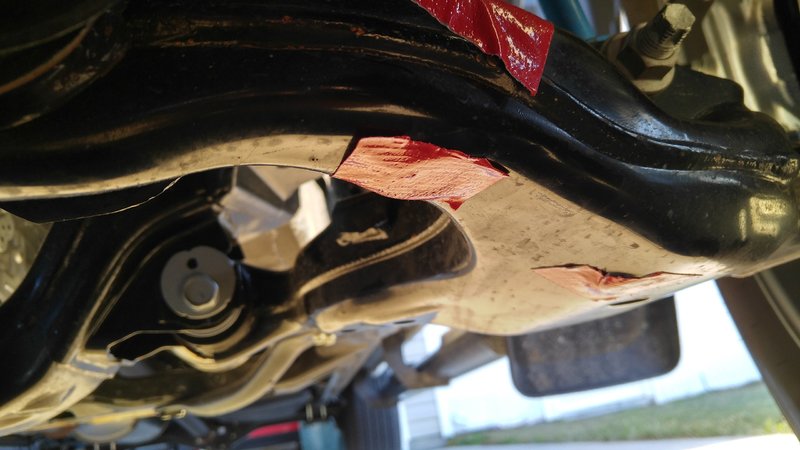

    AVS Bug Deflector. TruXedo Lo Pro
    No shit ..Right? I will be looking to measure the holes (IF it ever stops raining here) and look for plugs, As of now I used the red tape so people can see exactly what needs to be plugged.
    I am happy as a clam my truck is now perfect. But I think I still need to make sure region does not forgwt about this. We have over 20 offline members who are very happy. Kudos to Bob recruiting them and showing a solid front to Toyota.
    When I taped all the holes I moved the sound to 55-60MPH but it was weaker. I did not want to live with that so I experimented with different combinations. If you don't have the exact howl in the SoundCloud file in the OP, you may have a different issue,
    There are 3 or 4 "noise" issues in the forum. Many of them wind noise without the howl sneaking in here and there, This one acts the same on every truck and all the off line members have this exact sound.

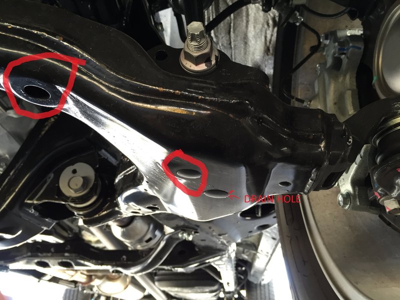

    Did you do both sides? There is one on the top of the arm I covered to keep water out as much as possible
    We actually only covered the front hole and the second one in and left the third one you covered open as that is a low hole and needs to provide drainage for the arm or water may get stuck in there.

    2001 Tacoma double cab
    Bella, Thanks for the quick note. With your guidance, I moved the plugs to the front two holes. They are both 9/16, so I had to make another Ace Hardware run. While I was there, I also plugged the hole on top.....it is a 3/4" hole.
    Photo showing the front two holes plugged with 9/16 plugs. Photo taken in front of drivers side looking aft.
