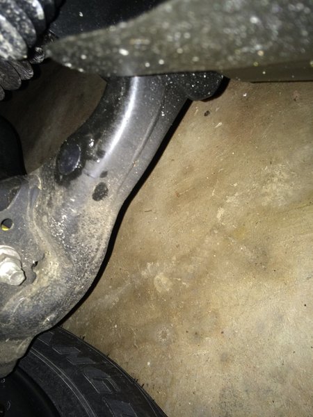

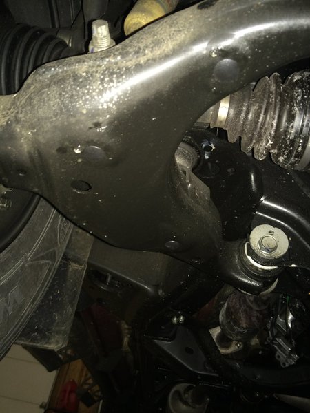

    From my measurements, 20mm should perfect for the top.
    I found some on Amazon, but didn't feel like waiting.
    I just cut a piece of electrical tape in half and wrapped the 3/4" Hillman plug till it fit snug.
    The 9/16" hillman plugs from lowes fit perfect in the smaller lower holes. Need 6 of those for both sides.

    3 on each side?

    Correct, I left the lowest one on the bottom open for a drain as previously discussed. 3 small holes on the bottom and one large on the top.

    Bella, I went back to Ace Hardware again yesterday afternoon to plug the holes in the passenger side control arm too. I could hear the same howl (but not as loud) while sitting in the passenger seat at 45 mph. My holes are the same size in both control arms. 9/16 plugs fit perfectly in the two front holes of the arm.....on both the driver and passenger control arms.
    Maybe there are different size holes or drain hole patterns in these control arms???? This would explain why some howl and others do not.

    Yeah you are right. I must have bought the wrong size. I tried a 1/2" but lost it in the arm. Could not fish it out but its to small to cause any noise or rattle issues. I Think they are the same. 9/16

    Gearcruncher,
    By plugging these holes do you think there will be a build up of moisture and corrosion because of lack of drainage?

    Its not my fix but I cant see why drilling a tiny hole through the rubber plug wouldnt allow any moisture to drain out and continue keeping the sound down

    I don't believe it will hurt anything to keep the two holes plugged, there are plenty of other holes for which it can breathe and dry out one is on the lower part. If for some reason you think it might be holding moisture after heavy rains or something like that you could always pull one of the tapes off and check. Also putting a slight slot in the tape with a knife would help drain and I don't believe you would still have the whistle, also I don't think it's going to be that long before they have a fix

    I can't see Toyota doing any other fix than the same or similar plastic plugs we are putting in.
    Pretty simple/cost effective, they look fine, should last forever.
    I'll be pretty surprised if they do anything else.
    I understand the mentality of paying a lot for a truck and wanting an OEM fix.....
    But honestly on this one, you guys waiting for them to fix it are just going to get more aggravated and spend a lot more time scheduling it in for service than a 10 minute trip in lowes or homedepot....or order from Amazon.
    I had my truck undercoated before winter, so I still had a lot of product up in my lower control arm.....
    If you are really concerned about lack of drainage causing rust, I would get a can of fluid film and shoot it up in there before plugging.
    Agree with others that a tiny hole through the plug would be fine to for extra insurance.
    Personally I just left the lowest hole unplugged and I'm pretty much 100% confident that it will drain fine and not cause any rust issues.
