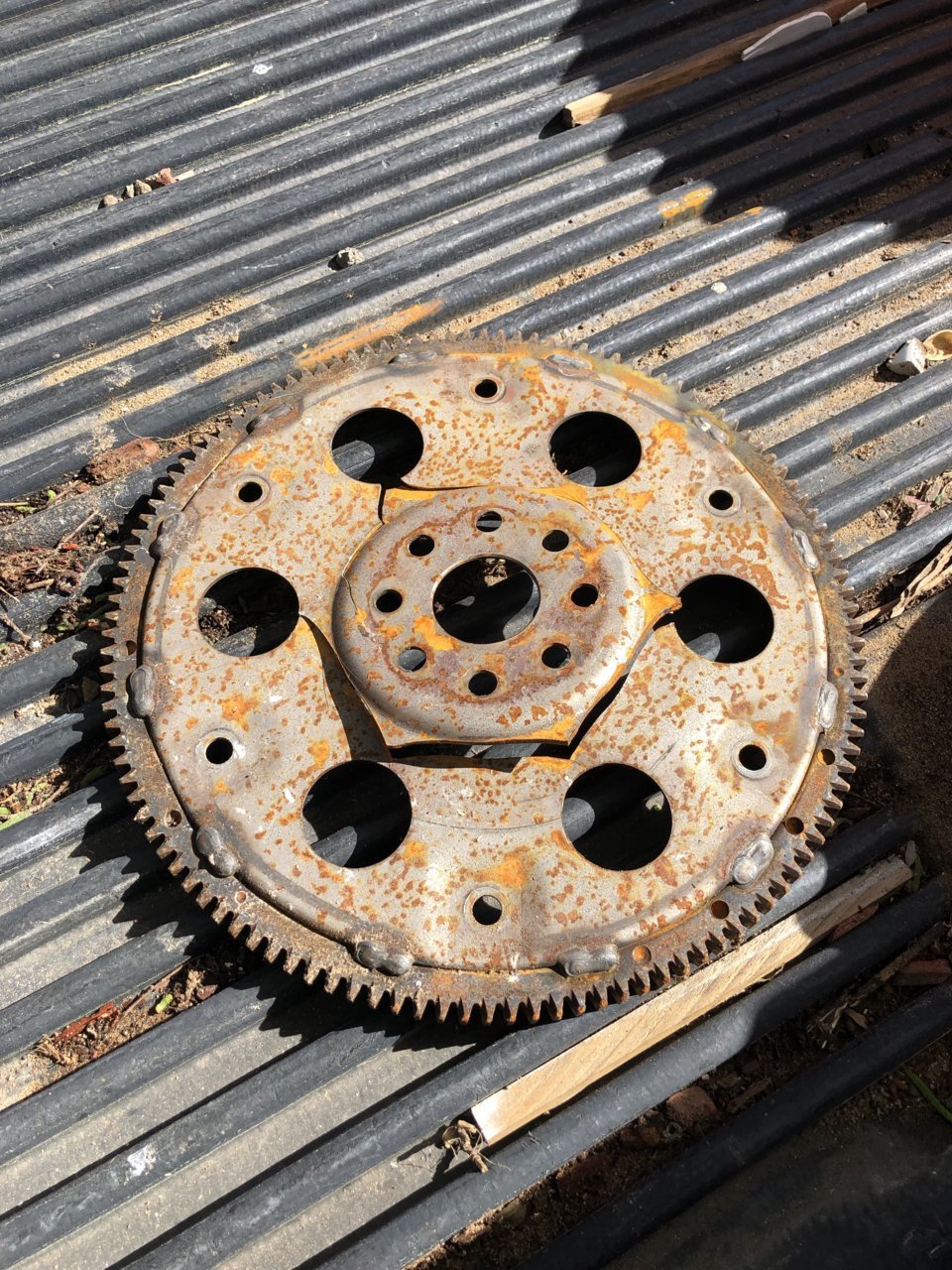

    SOLVED. It was a pretty shredded flex plate. Runs like a top now.

    How the heck did it get so rusty??

    If THAT was driving my transmission input shaft via the converter, I wouldn’t be able to sleep at night. Geeeezus
