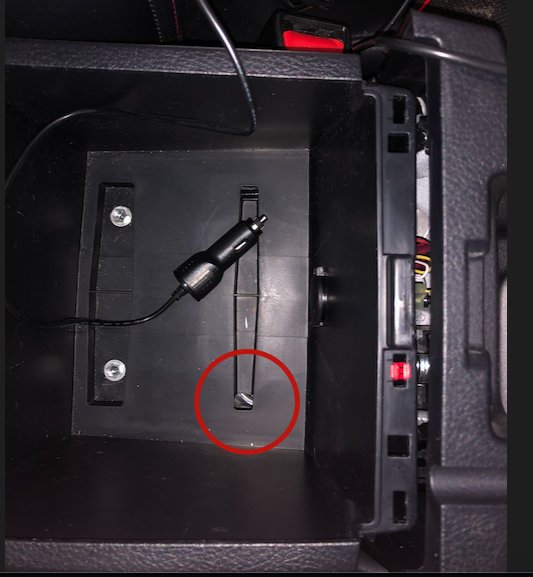

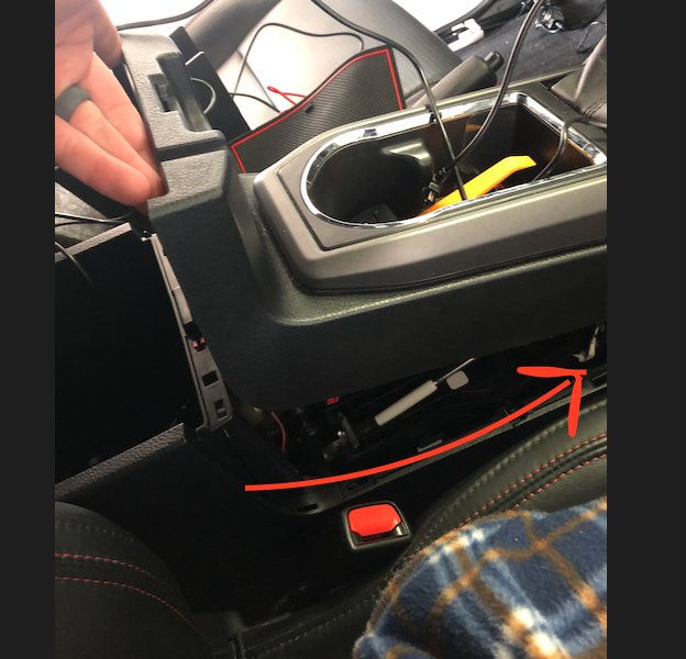

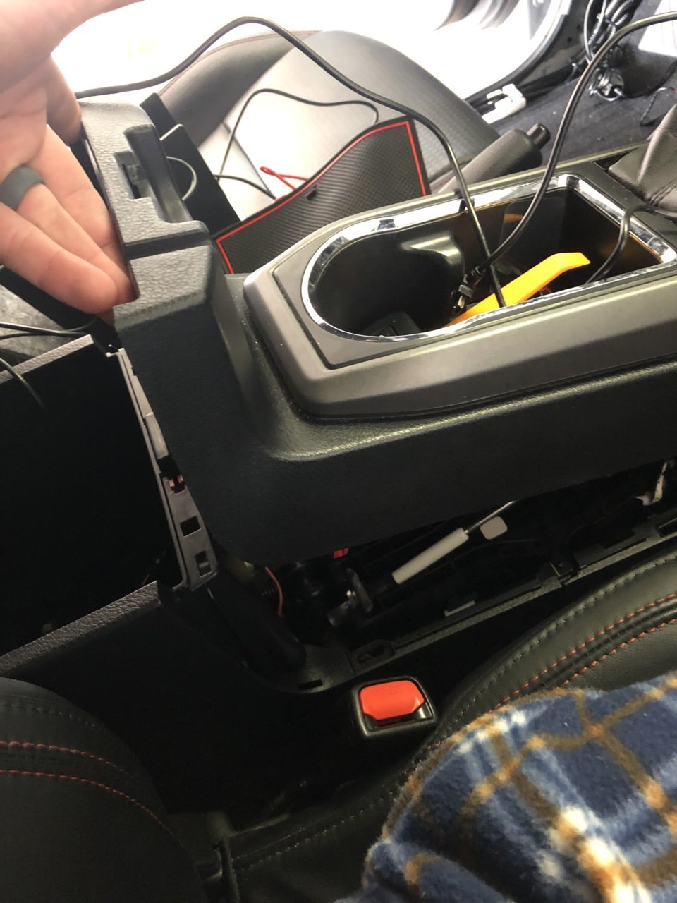

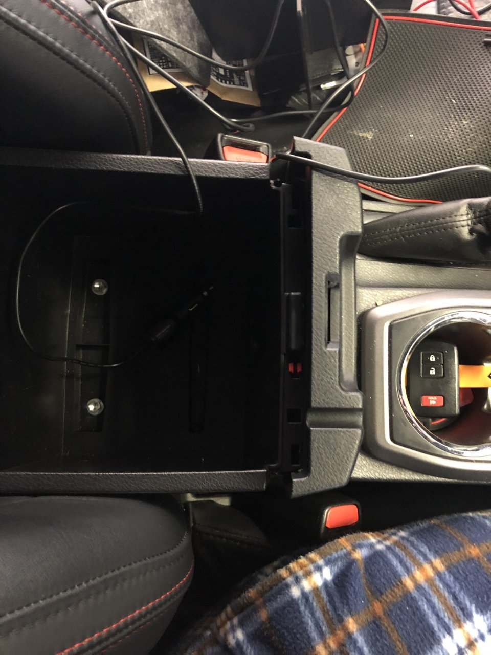

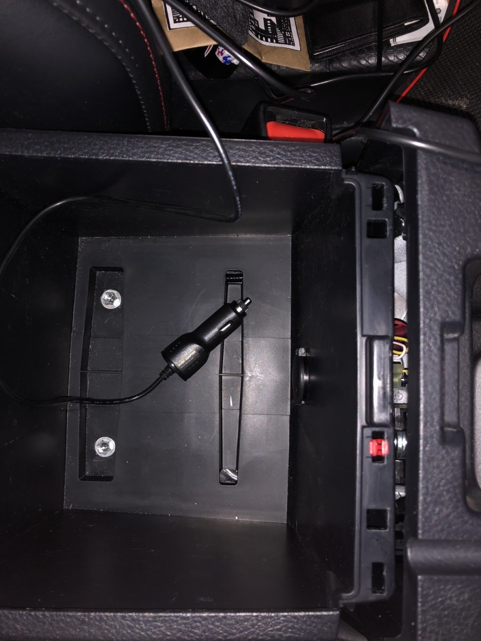

    I ended up trying the included 12v cigarette adapter, and it works like a charm. I just routed it under the armrest, through the center console and up the passenger side pillar. Everything works perfectly now.
