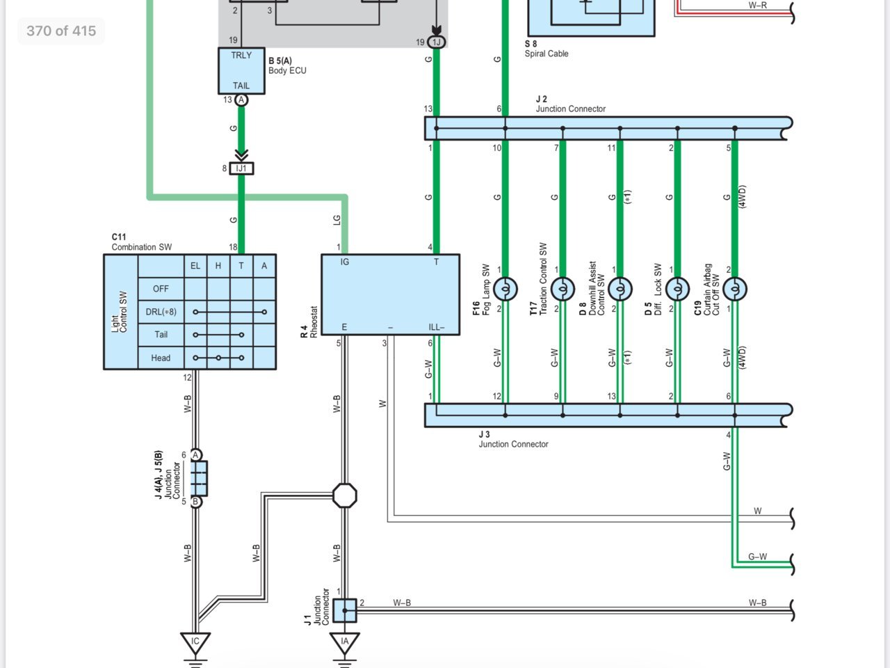

    I can't seem to find any wiring diagrams for the dimmer circuit. This is all I could find, granted it's for an 06 but it's worth looking into maybe.

    so are you guys saying that it might just not be plugged in? And is there a way to remove that dimmer switch without breaking something and without taking the dash apart?

    With the dimmer rheostat unplugged the lights will come on full bright if there isn't another issue involved.

    I suppose I'll take it apart and try to see behind it tonight

    So I was able to just pry the dimmer switch out without taking the dash apart and it is not plugged in at all and I don't even see the cord behind it to plug it into.

    SOLVED!!!! It seems that one of the previous owners had unplugged the dimmer switch and plugged it into one of the blanks below. one of the blanks accidentally popped out when I was messing with it and I noticed it was plugged in so I plugged the dimmer switch into it and Bam! everything worked. Why on Earth somebody would do that amazes me but I'm glad I figured it out. Thanks for those who contributed to the problem solving
