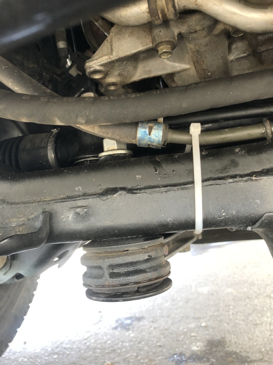

  13. May 4, 2019 at 4:23 PM
    #33
    Norilsk
    Norilsk [OP] Well-Known Member
    Nov 12, 2015
    #169435
    8,339
    Eugene
    J100 (Bougie) & UZN215 (Spartan)
    had the steering replaced, but found this under the truck few hours later, I guess they are officially zip tie certified :devil:
    plus my front diff electrical plug was disconnected, I wonder if they dropped the diff to do the work?
    Can somebody check how those lines are held?
    TeecoTaco likes this.
