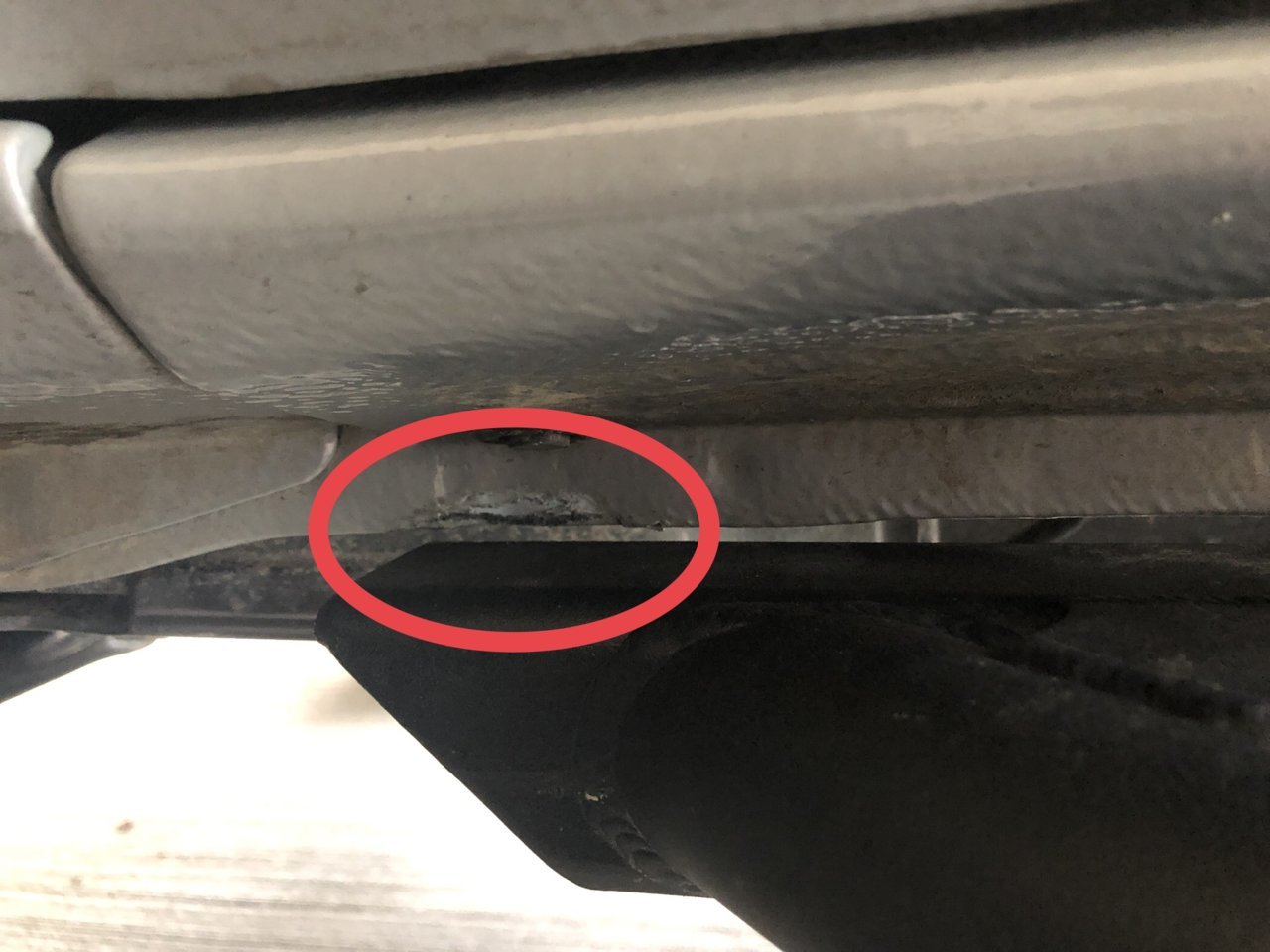

    Final update, I had my follow up appointment at the dealership. Went for a test drive with the technician to try and replicate the sound and also showed them the video that I posted earlier. A couple different technicians looked at the truck and were fairly stumped on what the sound could be. I wasn't very hopeful that they would be able to find the problem. However, once the technician got the truck on the lift and shook the truck by going up and down with the lift. He saw that the drivers sidestep was coming into contact with the pinch weld at the front of the cab. The dealer didn't charge me anything for their time which was really nice.
    So that was the clunk sound I was hearing all along, caused by the aftermarket sidesteps that were on the truck when I bought it. I have since taken off the sidestep and readjusted it.IMG_1387.jpg
