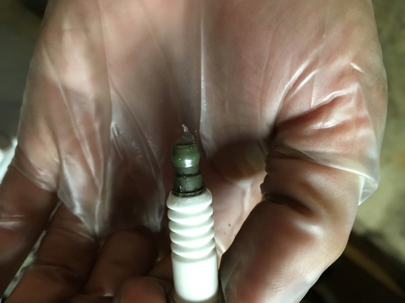

    Btw when I pulled the plugs I saw that I put dielectric grease in the boot.
    Here's a pic of a new plug I took out before I cleaned it. I shouldn't have even used the grease. Just cost me time.

    Yes, the grease goes on the boot, not the connection.
