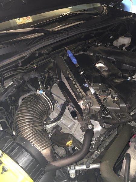

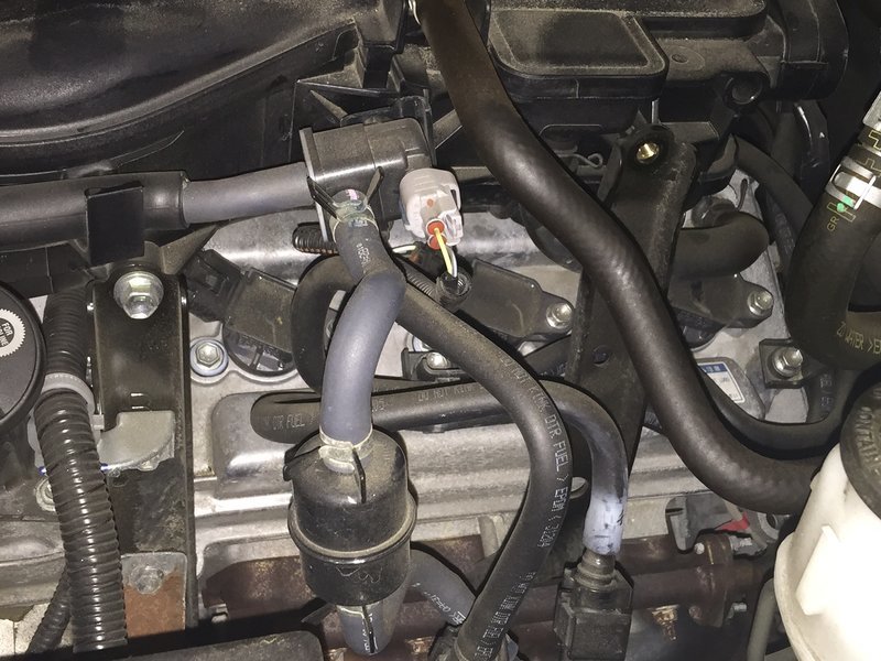

    UPDATE: I did find some links (thanks all) on the Spark Plug change. Its pretty straight forward. I bought my plugs directly from the dealer. While I was there I asked the Head Mechanic about rumors of people putting one type of plug on the drivers side and another on the passengers side. This guy actually teaches at the university here so I kind of respect his opinion. He has over 30 years working mostly on Toyotas. Doesn't make him Toyota God, but I'd say pretty versed in the vehicle. He stated that he had never seen nor hear of people doing that before and doesn't recommend it. He stated that in the V6 all 6 plugs should be the same. He thought maybe people where trying to get a performance gain. Just my 2 cents on the topic. Anyway, the plugs cam pre-gapped, but I checked them anyway. All were identical. The passenger side was pretty straight forward, but the driver side...well, lots of stuff to get out of the way. After I took the brackets and basic hoses out of the way, it wasn't too bad. I did use Ant-Seize on all my plugs. Did one at a time and when completed, turned it over for a test. Behold, no issues and took me less than 2 hours. Way to save some $. I love a vehicle that I can actually work on.

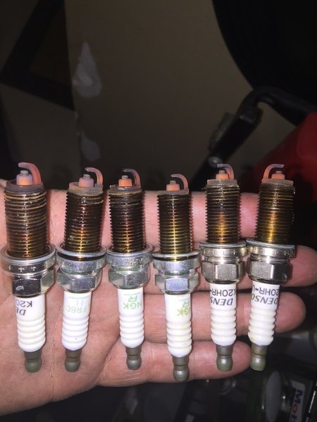

    What he was trying to tell you was that from the Factory one head has Denso Plugs and the other head NGK. When you do your change you can just use 6 of the same brand.

    I asked my local dealer what type of plugs do they use, yesterday while getting a free oil change, he came out with a Denso.
