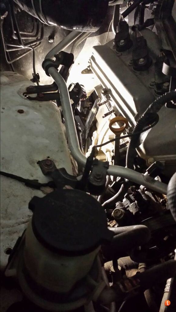

    Wow, I forgot about this thread. After a lot more searching I tested the fuel pressure and it was very low! I'm almost surprised it was still running. Anyways I replaced the fuel pump with a walbro255 from URD and pressure is back up, codes are gone, and she runs beautifully.

    Hey sandman looked every were for this same problem surging lurching feel . no codes or anything, any way found your post. thanks, how did you check fuel pressure I couldn't find pressure port on my 06 Tacoma 4.0

    There is no port on our trucks but you can add one easy enough. I have used this Dorman Tee but it puts the fuel line at an odd angle. I just ordered this Nitro Express (16190 5/16-8 mm) fuel line adapter and will be putting the pressure port in it.
    http://amazon.com/dp/B00CMB4I62
    http://amazon.com/gp/product/B003BBFOZQ
