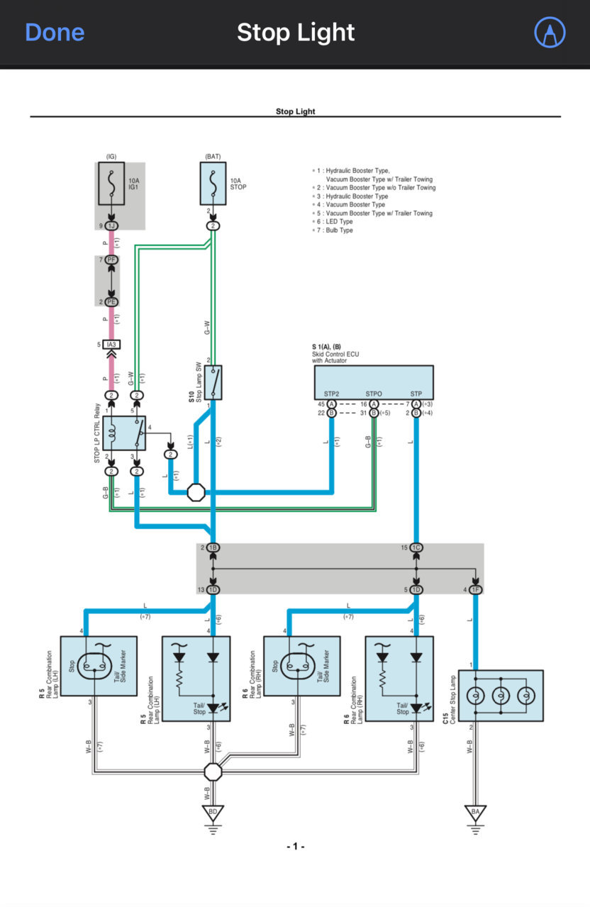

    @TnShooter linked me the post with all of 2015’s diagrams, but I’m not knowledgeable enough to understand them yet to go any more in depth than being instructed what to do and replying with information.

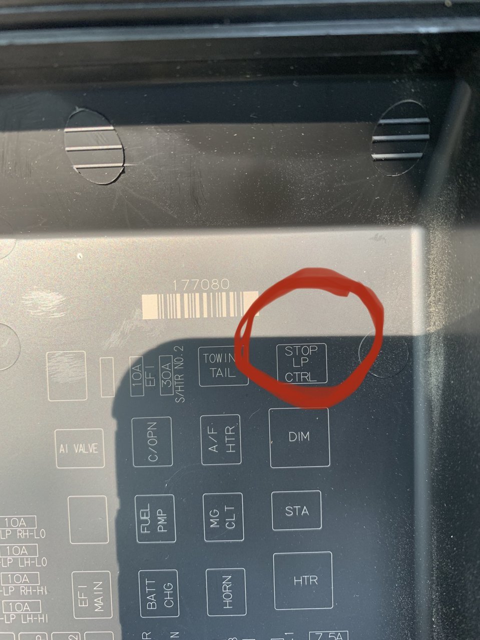

    There is a relay that I’m curious about in the main fuse box- STOP LP CTRL; I wouldn’t think a relay would burn out this young but I’m down to thinking it’s a headlight switch issue, a relay, or chasing ground points. . .

    The brake light switch is working, or the 3rd brake light wouldn't work like it's supposed to.
    I think you're going to need help there. Or bring it to a shop competent enough troubleshoot it. I'm pretty certain it's just wires got swapped, wrong bulbs, or possibly a short in a trailer connector.

    Here’s a diagram that looks like it may help to someone competent:

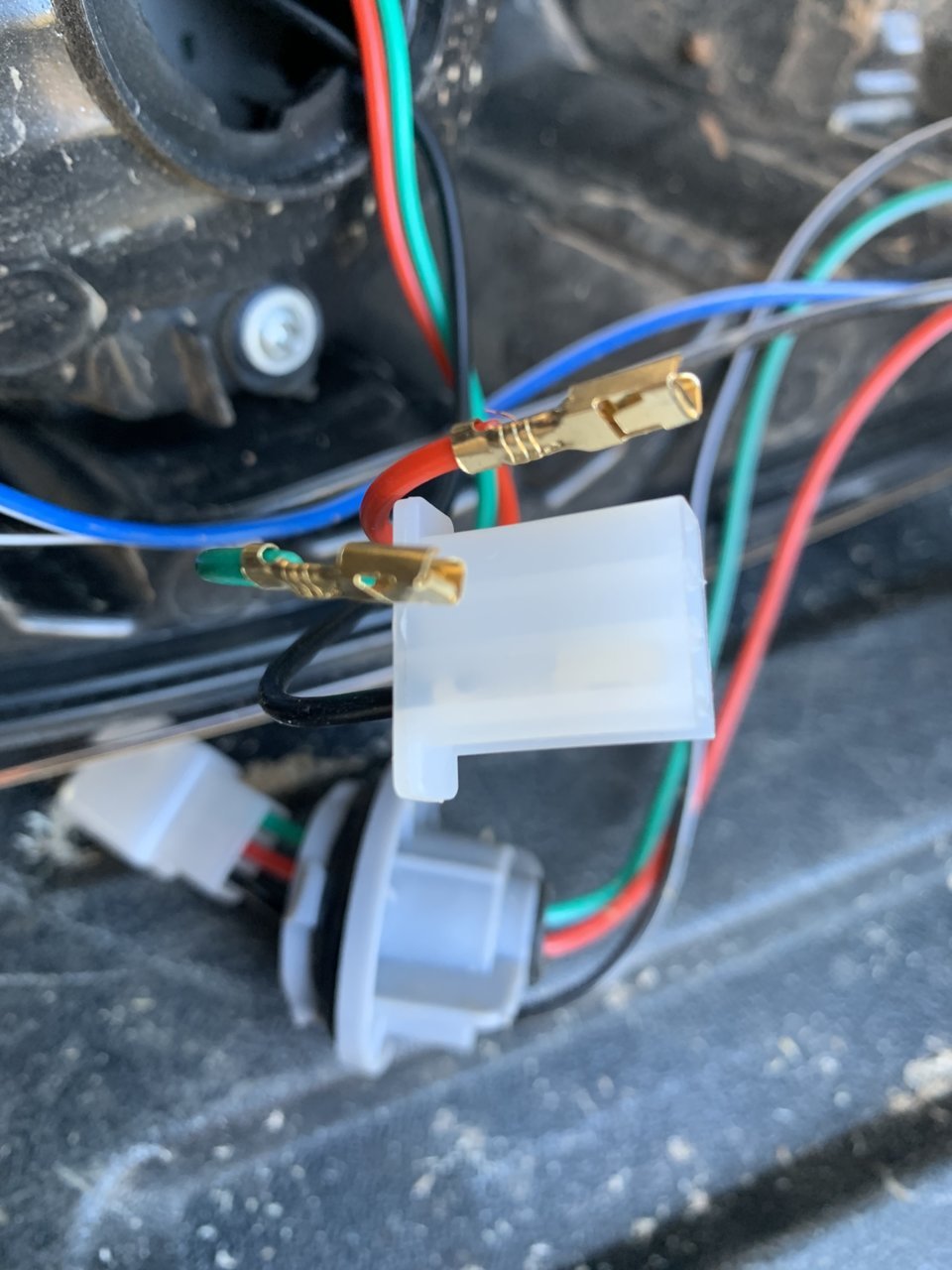

    From where I am sitting it appears that the Green and blue wires are swapped. The LED lights should not be effected by the headlight switch at all since they are different circuits.
    Blue is for the stop lights and green is for the tail lights. Both circuits use the White/black stripe for ground.
    SR-71A and TnShooter like this.

    I’m with him.
    Green and Blue are consistent.
    Green - Tail
    Blue - Stop
    This picture doesn’t look like it matches up to me?

    There's your problem!
    On the left taillight assembly, the one with the closeup plug photos, the red/white and the green wires are swapped at the connector. I assume the same is true for the right side, but I don't have a closeup of the plug to prove it. On the photos, I traced each wire to the backup light, stop/tail light, and turn light on both sides.
    You only have to swap the red/white and green wires on each taillight. All the others are OK.
    Pin 1: Left side: The solid yellow to blue/white connection is OK. Right side: Should be blue/white to blue/white. Turn.
    Pin 2: Green on harness is right. Red/white on taillight is wrong.
    Pin 3: The black/white to black/white connection is OK. Ground
    Pin 4: Blue on the harness is right. Green on taillight is wrong.
    Pin 5: Red to yellow/orange is OK. Backup
    On both taillights,
    the top row of wires should be blue/white, green, black/white
    the bottom row of wires should be red/white, yellow/orange, empty
    At the taillight, these are the correct wire colors. They all match the wire colors on your wiring harness, but not your taillight:
    R5-1 Turn Left: Yellow
    R6-1 Turn Right: Blue with a white stripe
    R5, R6 2 Tail: Green
    R5, R6 3 Ground: Black with a white stripe
    R5, R6 4 Stop: Blue
    R5, R6 5 Backup: Red
    R5, R6 6 Empty
    R5 is the left plug. R6 is the right plug.

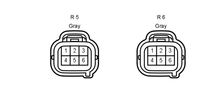

    Pin numbering. Male and female sides are mirror image. To identify pin numbering on the connector, find the empty hole. It's always pin 6.
    1 2 3
    4 5 6
    Since half of the ten wires on the two taillights aren't the Toyota colors, I'd bet those aren't the original taillights.
    My theory: The previous owner installed new non-Toyota taillights, probably to make the truck look better for sale. The new taillights came with the wiring mistake. They lit up, so the previous owner was happy and didn't notice the problem.
    The swapped wires in the taillights explain all the symptoms. There is no reason to believe you have a problem with a ground, brake light switch, relay, or computer board. My information came directly from the factory 2010 Toyota Tacoma Electrical Wiring Diagram book.
    Though that's where the mistake was made, I wouldn't try to remove and swap the wires in the connector. If I could open up the stop/tail part of the taillight assembly, and find the wires are soldered in there, I'd unsolder them and swap there. If soldering isn't for you, I'd just cut the wires and splice them with waterproof heat shrink butt connectors. The red ones are probably right. You'll need blue if they're too small.

    Here is a plug Pin Diagram.
    It might help make it a bit easier.

    Soooooo the pin extractor came in a full day earlier(thanks Amazon).
    I was out the door as soon as it showed up, and went straight to work. @Jerry Bear I followed your wire up chart, swapped the red and green wires on the tail light itself, and presto chango, I now have properly working brake lights!!
    I did look inside the bulb housings at the idea of desoldering and resoldering them, but they’re terminals that would’ve been harder to deal with than the pins. In the end, the taillights are wired properly to plug and play should I change them out and someone else want them, so there is that.
