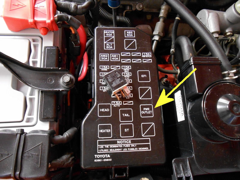

    I just had a thought, I'll let it out so it doesn't die from solitary confinement.
    IIRC the engine guys claimed they powered the gauge from the power outlets right there next to the gauge. You can check this in a minute.
    Open the hood, pop open the fuse box behind the battery and pull out the power outlet relay. Marked PWR OUTLET on the box cover (yellow arrow). The relay is shown sitting on the box cover in the pic. It just plugs in. Grab it and pull while giving it just a little wiggle. This will prevent the outlets from getting any power when the key is turned to the on position. If the gauge is powered as they said, it should not light up.
    Granted this will not verify any of the other wiring but it will provide a clue.
    Honestly you guys should be able to pop off the trim where the gauge is and tell at a glance if it is wired in any way other than stand alone.
    Also you need to realize that if it is wired to the ECM and it is disconnected, some codes should be popping up. Remember, I am not at all convinced that it is. I have seen no evidence one way or the other.

    Glad you did. Tossed away some good ones awhile back.
    I agree, pull that relay. Should kill that gauge for all intents.
    Now if is pulled,,and it still lights up when keyed on,,we trace wires back. It's the only way to be sure.
