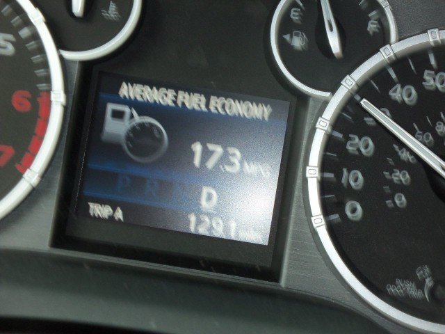

    I just had the Tundra out, 34 degrees, secondary roads, in traffic, up and down hills. I was going slower to take the pic; because of poor road conditions; if you are going to bitch about that. But this was the average.
    It does this everyday that temp is above 20 degrees.
    I have to wonder; but I Don't Care, how you drive.

    lol, my chevy has one of those fancy "lying to you" gages and it tells me I get 25 mpg but when I fill up at the pump and calculate it myself its only getting 16 mpg.
    those computer things just "guestimate" gas mileage based on your speed, throttleposition, and the ECM readings info, they are never accurate for what you really get
    I go up a bridge it says im getting 6 mpg and when I go down a bridge it tells me im getting 35 mpg lol, those mpg readings on these trucks are just something to lie to you to make you feel good.
    no truck anywhere gets better gas mileage then the sticker on the window says when you buy it, that's why it is illegal for them to use the false numbers on those gages on the window sticker, because they are proven to not be anywhere close to accurate. they are good as an indicator to help you get better driving habits by telling you when gas usage is higher but the numbers mean nothing beyond that.
