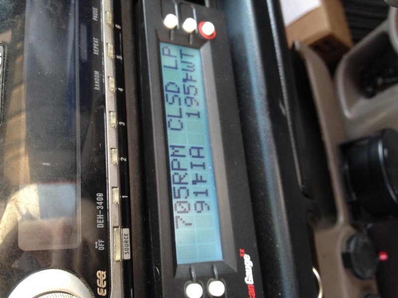

    Arrived to work and started truck after it was sitting all night. Intake temp (underhood temp) 71 deg, coolant temp 76 deg. Fuel pressure had completely bled off to 0psi. Truck still cranked and started normally under these conditions
    Drove around the block a few times to get up to temp, coolant temp was 195 deg and intake temp was 91 deg when parked and ignition turned off
    http://www.tacomaworld.com/forum/attachment.php?attachmentid=323788&d=1429662533

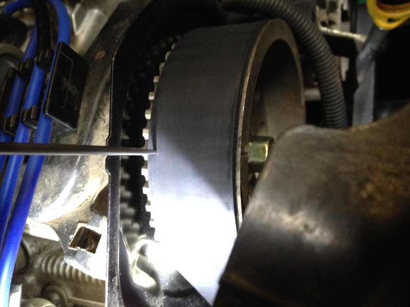

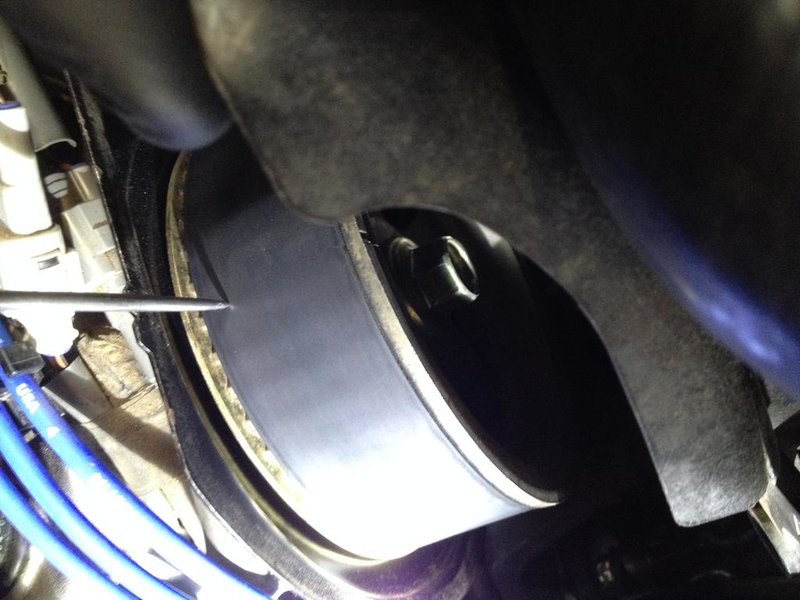

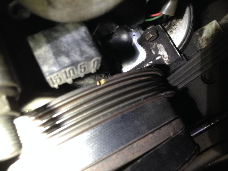

    Inspected cam timing/timing belt timing/valve timing and found that crank and cams all lined up correctly
    Crank
    http://www.tacomaworld.com/forum/attachment.php?attachmentid=323789&stc=1&d=1429665883
    Driver side cam
    http://www.tacomaworld.com/forum/attachment.php?attachmentid=323790&stc=1&d=1429665883
    Passenger side cam
    http://www.tacomaworld.com/forum/attachment.php?attachmentid=323791&stc=1&d=1429665883

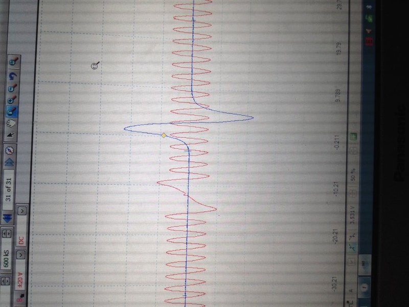

    Here is the oscilloscope reading of cam and crank sensors while running. The red trace is the crankshaft position sensor (34 teeth) and the blue trace is the camshaft position sensor (1 tooth)
    http://www.tacomaworld.com/forum/attachment.php?attachmentid=323810&stc=1&d=1429666086

    All of the sensors look good to me. Don't see an abnormal signal from either.
