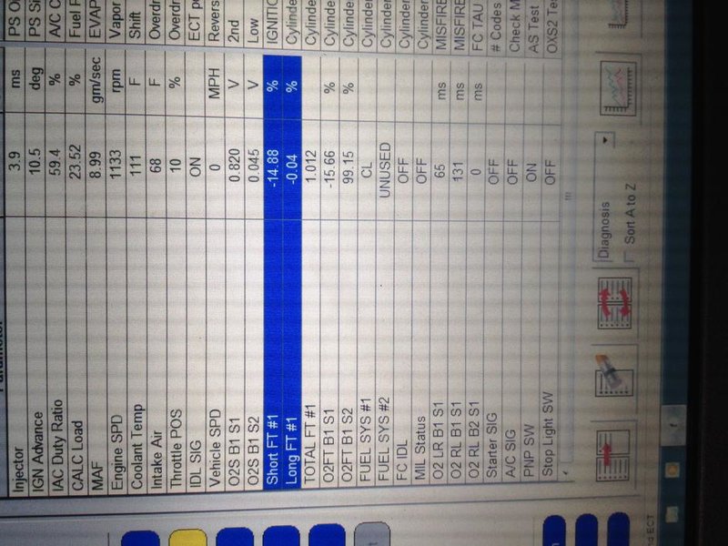

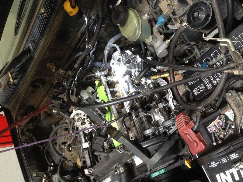

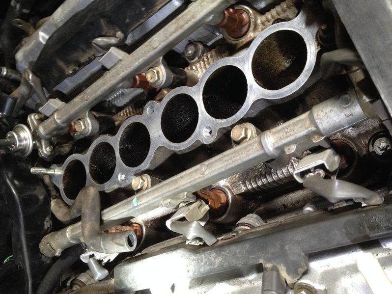

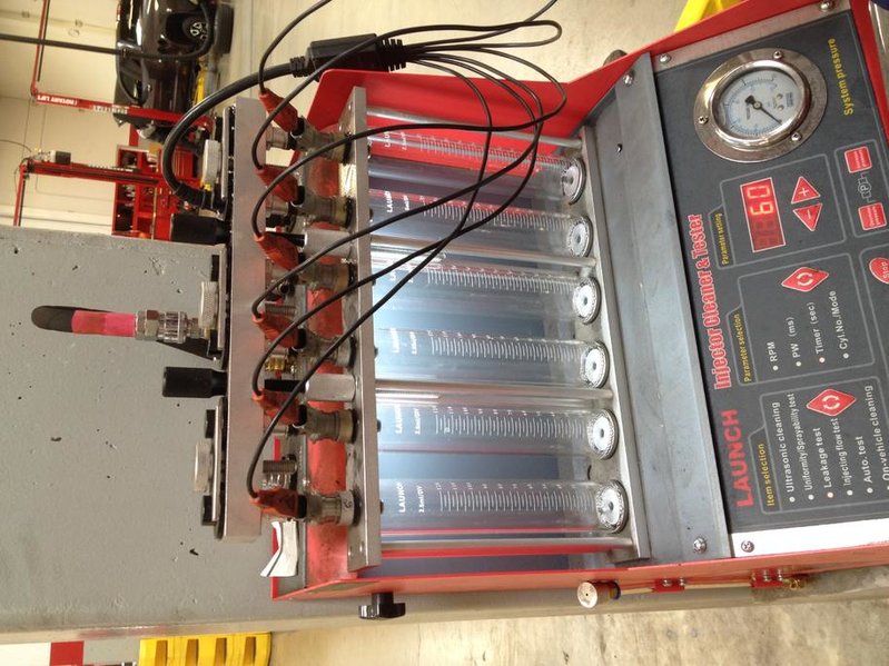

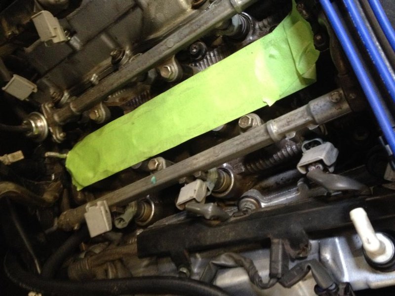

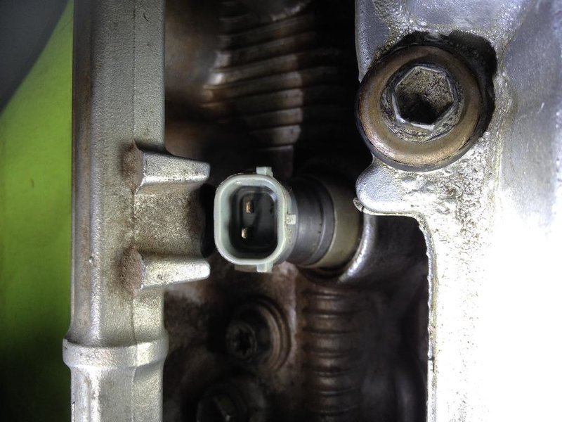

    Hi everybody today was awesomely unsuccessful! Overview is: no tight valves found during valve clearance check, swapped injectors are not correct for vehicle and no results could be taken using them, and no problems found with the original injectors :rolleyes:
    Now for the details and the pictures ..
    The patient is on the table.. inspecting valve clearance. I found no overly tight valves. Some were .001-.002 tighter than the spec limit but from experience this does not mean anything at all. I have seen tight valves before 3vz 3.0L that were hanging open and causing a problem. They looked very different they were very small clearance to no clearance at all aka could not fit .0015 feeler gauge in. These valves do not look like that at all I would give them a pass for the class. I have all the clearance specs that I measured but they are on a piece of paper at work :(

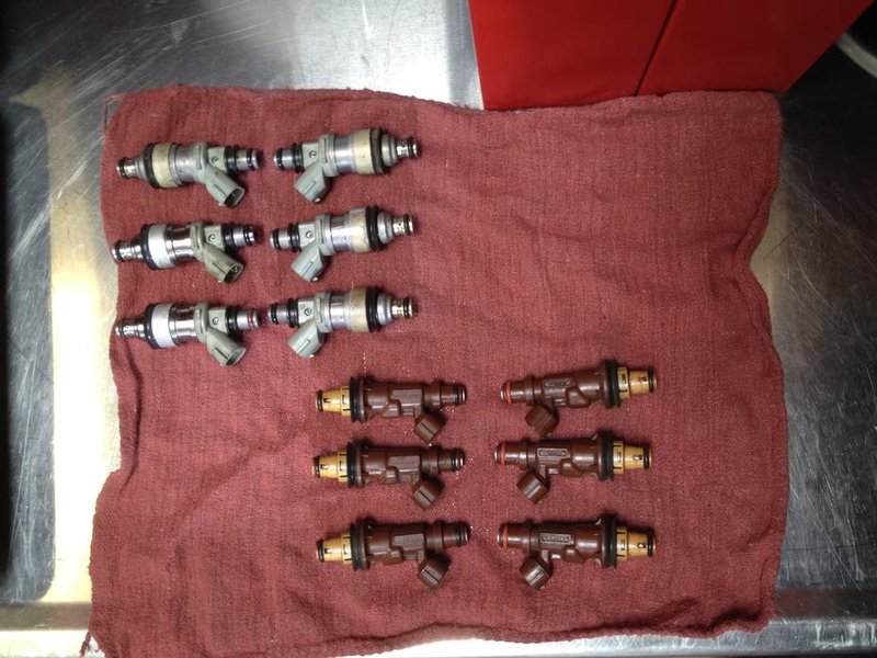

    The injectors in the truck are the silver colored ones. The spare set of known good injectors are the brown colored ones. I guess there is a split in late 1998 where Toyota decided to change the injectors (and the ecm). The spare set I have are the later ones. I thought what the heck I will give them a try maybe they will work. The intake manifold and
    fuel rail remained unchanged through the injector change so I was hopeful. BTW if you are ever thinking of doing this... DON'T. It doesn't work :)
    Here are the known good injector installed...
    .. And here is the immediate -14.88 sft. This means the new injectors are spraying a lot more fuel and causing a problem. So I idled the truck a bit and just called it a fail. Going back to the original injectors.

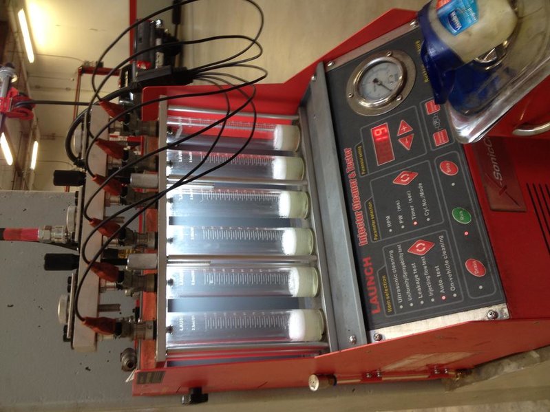

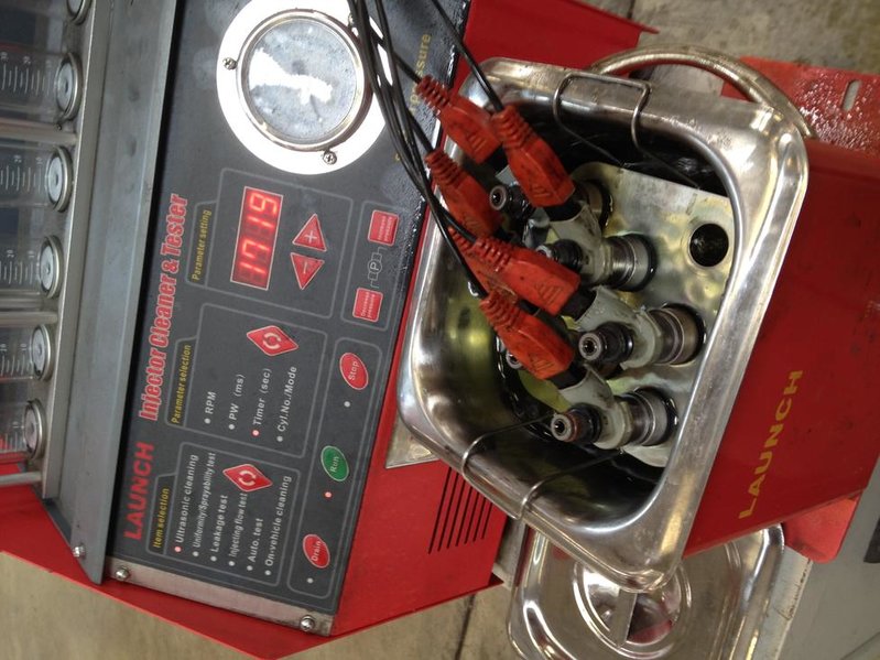

    Here are the original (silver) injectors on the testing machine at my work

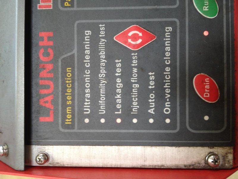

    Note the little red light is on over "leakage test" this indicates that this is a leakage test (I'm tired)
    Here is the leakage test in action. The machine has a 60 second timer for this test (not adjustable). So I ran the test twice. I did not see a drip from any injector during this test.
    This is the ultrasonic cleaning in simple green solution. From experience this does a really good job cleaning the injectors and will clean up fuel trim hugely if the injectors are dirty or clogged.
    So one step foreword two steps back, I would like the problem to jump out at me any time now. Going to put the old injectors back in and......um......when I think of something else to test I will do that :)

    Update for today Thursday 4/23/15: Re-installed original injectors
