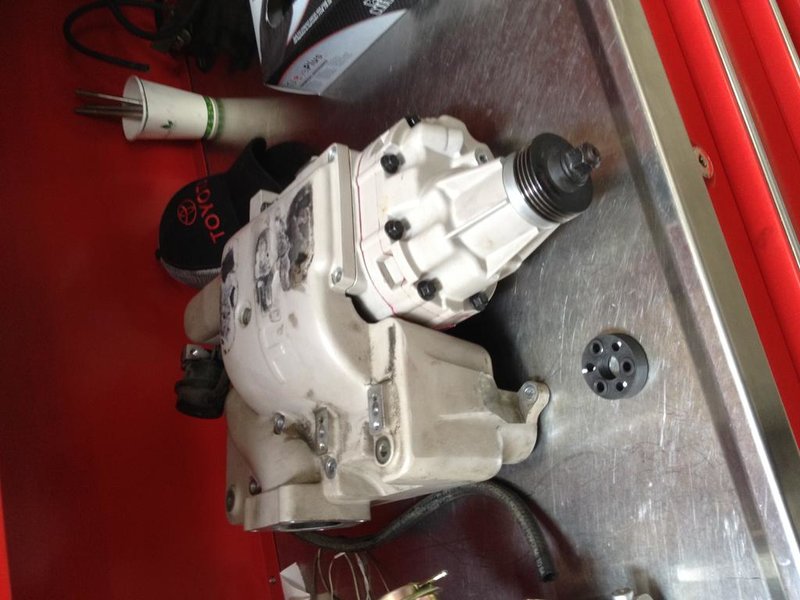

    This video is the Tacoma start up first thing this morning. The fuel pressure has bled down to 0psi overnight but it starts totally normally.
    https://youtu.be/5H_7NqLweR8
    This is a video of my 1997 4Runner. No modifications have been made to any system except that I put on a first gen trd supercharger recently so the pressure regulator is boost referenced this may or may not make a difference? As you can tell from the video these two vehicles have some way different fuel pressure characteristics. This start is not a first thing cold start this is after recently running the vehicle.
    https://youtu.be/_iDvwHF5S7A
    Gratuitous supercharger pic :)
    That little plastic donut is the coupler between the nose cone and the gears. it was bad (holes were egg shaped) and making a really bad knocking noise. Another tech replaced the supercharger unit with an updated newer version so I got this one life is sweet
