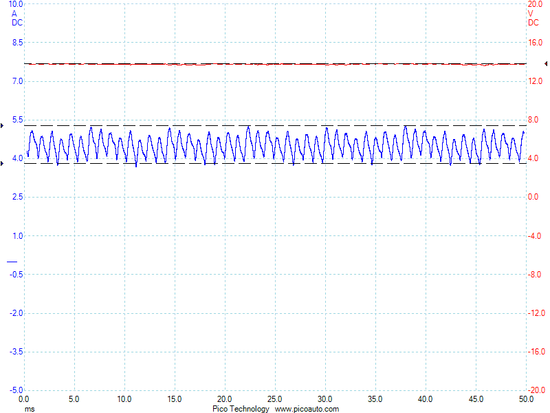

    Tacoma fuel pump current and voltage with engine running

    Nothing odd there. Every rotation of the pump armature shows load and unload. Volts a solid 13.7 or so.

    Would there be current and voltage during cranking, or not until the engine starts?

    There should be current and voltage present as long as key is on. There should not be much of an amperage change regardless of running or just key on. The fuel is always flowing, just what is not going to injectors is sent back to tank.
