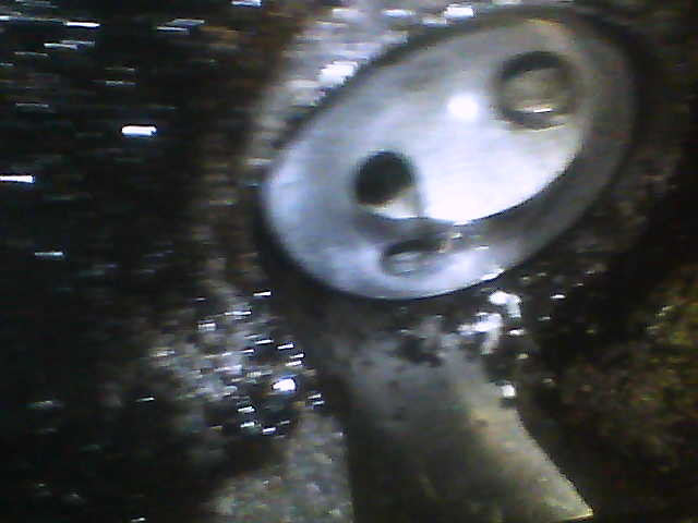

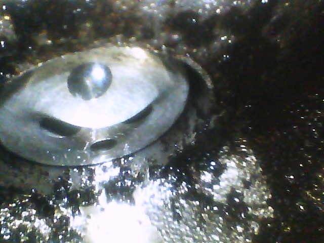

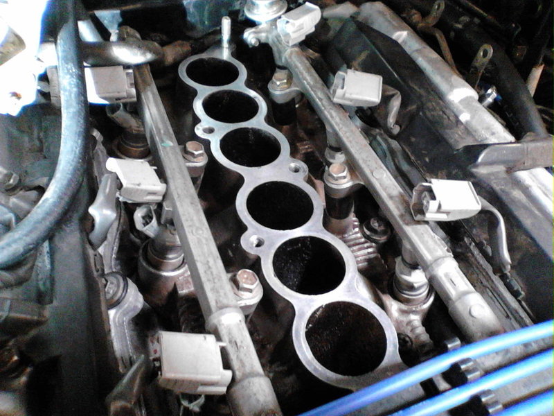

  15. Apr 29, 2015 at 10:51 AM
    #2875
    noahpete
    noahpete Active Member
    Apr 17, 2015
    #153369
    30
    Jay
    Beaverton, Oregon
    1997 4Runner
    Performed fuel injector leakage re-test this morning. Confirmed all the injectors were dry before doing anything else. Then ran the pump with the scan tool to pressurize the fuel rail and noted the following: Cylinder 1 and 2 are the worst leakers showing large drips (pics)
    Cylinders 3, 4, and 5 injectors appeared wet. Cylinder 6 appears dry
    All testing was done with injectors unplugged b/c some peoples were thinking there could be some problem with slight current flow or voltage issue
    Conclusion:
    So given that we can see the injectors are leaking fuel when the truck is turned off I seriously suspect that this is the extended crank / hard start issue after a hot soak. My recommendations are to replace the injectors with all new Toyota oem injectors. This actually might be kind of expensive so it could wait until further down the road you would just have to expect the hot soak issue is going to happen. The truck does always start after the extended crank. I have never had the truck crank and not start.
    dollysdad and lovemytacolots[OP] like this.
  16. Apr 29, 2015 at 11:00 AM
    #2876
    Jayman405
    Jayman405 Active Member
    Apr 17, 2015
    #153394
    28
    Jason
    Well folks, I think we have found the end to the mystery on this vehicle.
  17. Apr 29, 2015 at 11:03 AM
    #2877
    lovemytacolots
    lovemytacolots [OP] Show your Taco some love every day!
    Dec 5, 2014
    #143713
    3,269
    Jen
    Oregon
    98 3.4L V6 5vzfe 4wd TRD Off Road
    It starts correctly now, thanks to the best dealer tech ever.
    Holy cow. Am I dreaming right now? Did someone FINALLY find the hot start culprit? Unblankingbelievable. You are a genius noahpete!!!!!!!!
    Just called Eric the second I saw your post. He's gonna call me back soon and we're going to talk about what we want to do. I suspect we will have some questions coming your way, in hopes of getting your overall recommendations on a few things before making the big bucks ($1200:eek:) decision on the injectors. I know our concerns about the health of the engine are definitely on the lists of things we're hoping to chat with you about.
    But for now, thank you thank you thank you, you are an absolute angel for working so hard to figure this out for us!!!!!! :bowdown::thumbsup::cheers::yes::yay::woot:
    PS: cookie preferences? : )
    Jayman405 likes this.
