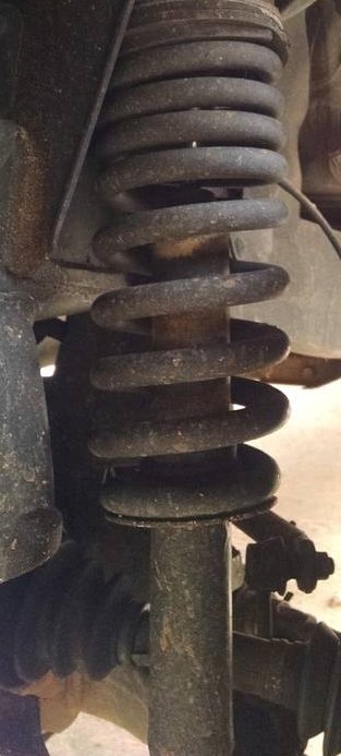

    The spring/shock thing might be worth considering. However you do have the warranty on the old fellows so you might consider some aftermarket stock springs to go with the new (replacement) shocks. The "TRD" package "progressive" springs were famous for sagging in just a few years. Of course if the ride and ride height is OK by you, then you could skip the springs, nothing bad is going to happen.
    What ever you do, treat the compressed spring like a loaded gun, be aware of the directions things will fly should the compressor fail or slip. The stored energy is enough to maim or kill.
    It might be a little late but if the ride height changes (more likely with new springs) you will need an alignment so measure the height first.
    I stole this pic of a TRD progressive coil. See how the upper "softer" coils have sagged to the point of nearly touching. This is an extreme case.

    Thanks you guys!! Here's a pic of what our coils look like....
    Meanwhile, smart ass neighbor with good tools and creepy clown figurine was outside just now. Asked about the clown, he had it on his workbench! Said he's going to plant a cactus in it, you'll see why that's kind of hilarious when you look at this pic......

    Jeezus, how come you didn't take the pressure washer to that. Would have made Eric's job a bit easier.

    I never know if I'm gonna spray something I shouldn't. Which makes no sense, considering I live somewhere that I basically drive through river sized puddles most of the year....
    EDIT: geeze, you're right. just looked at the photo again, and that is nasty. oops.

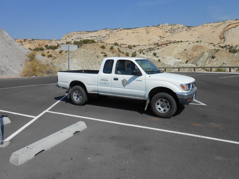

    For your type of use, them coils don't loo too bad.
    More "meanwhile".
    Tasteful Co graphics, Dinosaur NP.
    lovemytacolots[OP] likes this.
