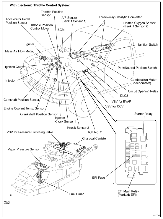

    I just took a look at my AlData account and found this diagram. It shows quite a few of the sensors on out motors. I wonder if that coolant temp sensor is bad or if there is a cut wire?
    Here is the diagram if your interested.
