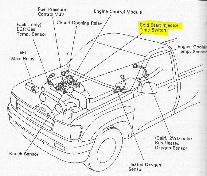

    In looking through Haynes manual, found this diagram - it looks like we have a cold start injector, like the mechanic mentioned. I think someone said we don't - so I'm wondering if this diagram is right, or ?????? Could that thing have something to do w/what's going on???

    This is one of those times I wish you had a scan gauge. You would be able to see if the truck is running in "open loop" after it was good and warmed up. If that temp sensor is bad, the truck would be running in "open loop" the whole time. The gauge would tell yiou what your actual engine temp is. The onboard temp gauge in the dash is rediculously inaccurate.

    Here is a better pic.
    What you are showing is a timer, not an extra injector-those are for super charged engines.
