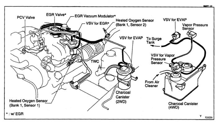

    Dirty Pool
    Dirty Pool FLIES ON THE FRIES, KETCHUPS WATERED DOWN
    Mar 24, 2013
    #100471
    2,325
    59.4 Miles, 56.67° NE Of Moab
    99 XCAB V6 MT TRD
    Dirty Pool rear bumper/air tank with integrated spare CV shaft storage, DP customized TJM front bumper, 8000 lb Ramsey/Technora rope, E-locked, Extended breathers with front diff catch can, PCV catch can, SAWs with DP heim joint seals, DP custom 6 leaf rear springs/Billies, DP custom skids, 2lo, Gray wire, Cap, Bed Rug, Black steelies, 01 Center console, Map lights, Disraeli gears
    What kigmob said.
    So the rest is still a guessing game?
    When you talk to your guy ask him specifically how the fuel pressure was checked and what degree of OBD2 diagnostics have been done. Fuel pressure test requires a gauge to be plumbed into the fuel system. It's not like checking tire pressure. The recommended spot on the 3.4 requires removing the upper timing cover (big black plastic thing beneath the upper radiator hose) and installing an adapter then the gauge. Because of this many people including "techs" will go on hunches and principals they "think" they understand.
    EGR valve? I don't think you have one. They are listed for "some" 96 v6 models and no 99s. I only have 96 and 99-up FSMs.
    If you have one it will look like this, at the top rear of the engine.
    Idle speed? Idle speed is controlled by the ECM via the IAC valve. Essentially a controllable air leak into the intake, bypassing the (closed) throttle plate into the intake manifold and additionally a series of small passages leading to the injectors. The throttle plate should be closed and the adjustment not tampered with unless it doesn't close or sticks closed (not due to crud).
    Generally a code will not be set unless there is an electrical problem with the valve as opposed to a sticking or binding issue (dirty).
