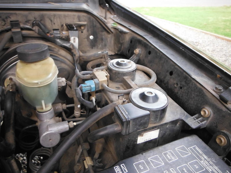

    Guys, just started again, and got the faint clicking sound. Recorded it, and somewhat isolated general area it's coming from. Actually popped the hood (never do that - I research, husband does stuff - feeling kinda proud!), in search of EGR valve - never did find, but at least I tried, w/both crappy manuals, looking at a million different diagrams. Looks so straightforward in the books, then you lift hood and it's a different story. Anyway, gonna upload video of clicking. Apologies for poor explanation, but it's coming from the area under the hood that is directly behind steering wheel/dashboard gauges. Is that where the charcoal canister is?

    Mmmm, steaks - sounds good. Enjoy! Video quality of clicking is really piss poor, this camera sucks. Where the hell is the charcoal canister, just in general?

    Booze talking or seriously do this? What will this tell us? Where's the charcoal canister?

    its under the hood on top of the fender well, its a black box with several rubber hoses connected to it
    its about the size of a lawn mower battery and this is what it looks like: https://www.rockauto.com/catalog/x,carcode,1317613,parttype,5180

    No way!! So that's what it would look like in our Taco too, or at least pretty close? That thing is in the area of the clicking I heard, where husband said he heard it too. Hmmm. WTF that means, I really have no clue. But, another piece of this loooooong ass puzzle. It's all the way over on the right, kinda above the driver's tire area, right?

    Popping hood now to verify.....

    This thing, right?
