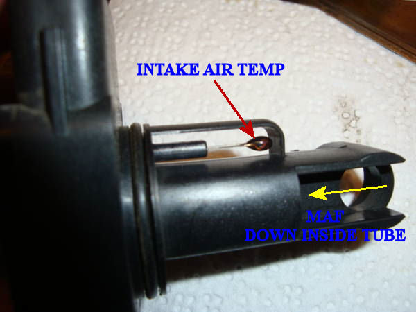

    One last thing. I'm sure someone has mentioned cleaning the MAF (mass airflow sensor). It and the intake air temp sensor are in the same little part and cleaned at the same time. Takes 10 mins with a screwdriver. Both sensors can have an effect on idle speed/stability. If you need the location and technique, I can get a pic up tomorrow.
