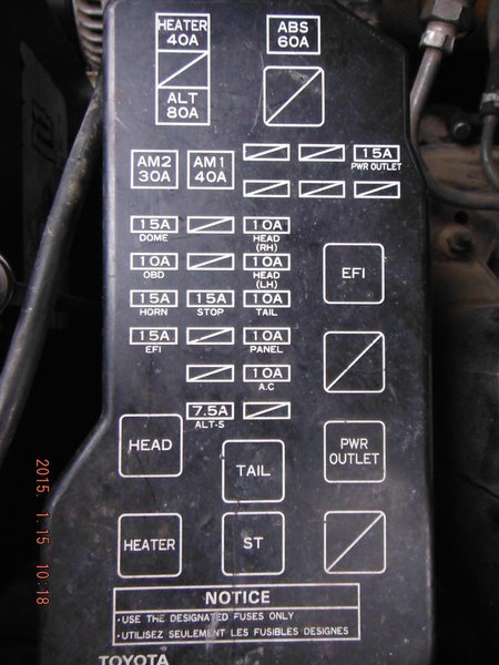

    Morning everybody!
    Started great cold early this AM, then started horrible ~1 hr later. Problem didn't magically fix itself yet. :rolleyes:
    Held a stethoscope up to charcoal canister, and the clicking/tapping noise is definitely coming from it. Noise comes and goes.
    DP, thank you very much for the input on that - we wanted to ask, how should we plug the hose (what to use)? Then once that's done, should the click stop, or what exactly are we looking for and what would it mean?
    Also, looked at fuse box (you know, the thing next to the thing! sorry guys, still got a lot to learn, but last night's crash course helped a lot - hopefully you'll see less statements like that from me!).
    Koditten, we didn't see an obvious fuse for fuel pump. Any guidance on that? What are we missing here?
    Read more about IAC valve, and how one that is stuck open (they said ours was stuck, and pretty sure they said stuck open not closed) can cause lean condition. Makes sense, and imagining that thing being constantly open, coupled w/seeing it's location in relation to #3 cylinder, coupled w/failing injectors over there, and extra heat in that area due to location, all the puzzle pieces are seeming like a logical fit. Now leaning heavily towards having mechanic replace it. If we ordered part and did ourselves, we'd saved ~$30 - doesn't seem worth it, considering we'd be paranoid of damaging something in the process. Will likely call mechanic and ask them to order the part. They said it'd be 1/2 hr labor, so hoping when part's in, I can drive up and wait for them to swap it (at 30 miles away and w/husband's work schedule, it's tough to drop it off there).
    Going to give it 1 more day before committing $ to it (fear of an ongoing "throw more $/parts at it til it's fixed" scenario). Would the IAC valve malfunctioning/sticking cause lopes in RPMs at idle? We are definitely seeing occasional big jumps up and down in RPMs when idling - not a lot of them, not frequently, but it is happening occasionally. And as mentioned in previous post, last night RPMs went as low as 494 and Taco almost died, even at normal operating temp of ~200 (that is normal, right?).
    Also, waiting 1 more day seems worthwhile, so we can investigate all the other fairly easy (and FREE!) advice from you guys - DP's charcoal canister hose idea, Koditten's fuel pump fuse idea, see if Kigmob sees anything strange on video of under the hood, and also do this:
    - Thanks DP!

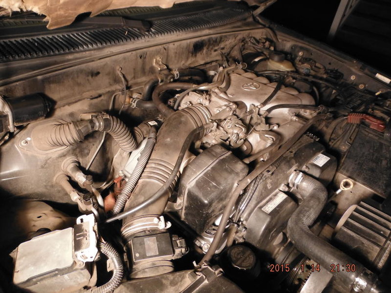

    Videos of under the hood coming next! In the meantime, here's a photo of under the hood, and a photo of our fuse box - anyone know which one is for the fuel pump?

    http://youtu.be/YbHP-jA3K7A
    Super exciting video #1 of under the hood. #2 under the hood while Taco is running coming next.........I know, you're all on the edge of your seat with excitement. :rolleyes:
    Seriously though, Kigmob and anyone else kind enough to take a gander at this, we really can't thank you enough. I don't doubt our mechanic's work at all, as the engine runs sooooooooooo beautifully and they really do seem like genuinely good guys who know what they're doing, but nothing to lose by getting more sets of eyes on it (we all make honest mistakes now and then, right?) :D

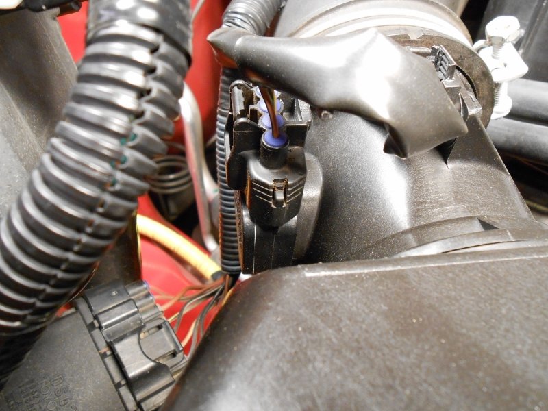

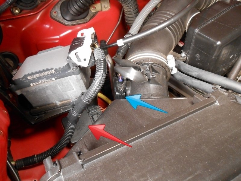

    Here's the location of the combo MAF, intake air temp. After removal clean with spray from a can of electronics cleaner, do not touch the sensor elements with anything but the spray. A few squirts will "rinse" them off and things will dry off in seconds. Remember the actual MAF element is down inside the tube (see the previous pic). Use a good light to see down in the tube first so as to get a feel for what the cleaner has done. The "dirt" will look like what it is, very fine caked on dust. No touch, no touch, no matter how tempting.
    Pass side, just down stream from the air box, blue arrow.
    Damn that's clean for a 99.​
    Closer
    From behind looking forward. The 2 visible #1 Phillips head screws hold it in. Short "stubby" screwdriver works best. Unplug the connector and gently rock/twist to pull it out of the intake tube. It has an o-ring for sealing so make sure it's not torn. No need to disconnect the battery.

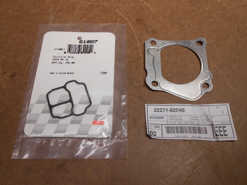

    Here is the best vid on cleaning your model IAC, right down to the wrong gasket many people get sold. The little screws holding the IAC to the t-body are tight. Take the time to find a screwdriver that fits well and keep it aligned so as not to strip the head.
    https://www.youtube.com/watch?v=RgpIg-WkwOY
    These are the 2 gaskets involved. The rubber one on left is from NAPA type stores, Felpro brand. The old one will likely have swollen over time and not fit back in place. The steel t-body gasket is from the dealer. Many folks reuse it, your call. Don't use a cheapo paper gasket.

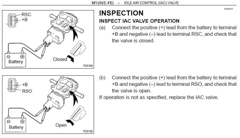

    IAC electrical test from the FSM. If this test fails it may be due to built up crud, so clean it before replacing.

    This. I checked my IAC with a battery, saw it move so I knew it wasn't stuck. Not to be a negative Nancy, but mine did the same thing. Sometimes it would start on a warm start and I thought the problem was going away. But eventually it would come back...
    Also, it looks like you have the tube like MAF and not the drop-in MAF. DirtyPool posted how to clean the drop in type which is on I think 99+ Tacomas. My 97 has the tube like MAF and I just clean it by removing it and spraying MAF cleaner into the center piece (this is where the sensing element is located) then let it dry for 20-30 minutes.

    Oh yeah, random question. Did anyone notice if we had an EGR valve in those videos, or the photo I posted? Pretty sure mechanic told me yesterday that we don't, although I have so much floating around in my head I'm not positive at the moment......

    No EGR. Everything looks fine to me from what I can see under the hood.
