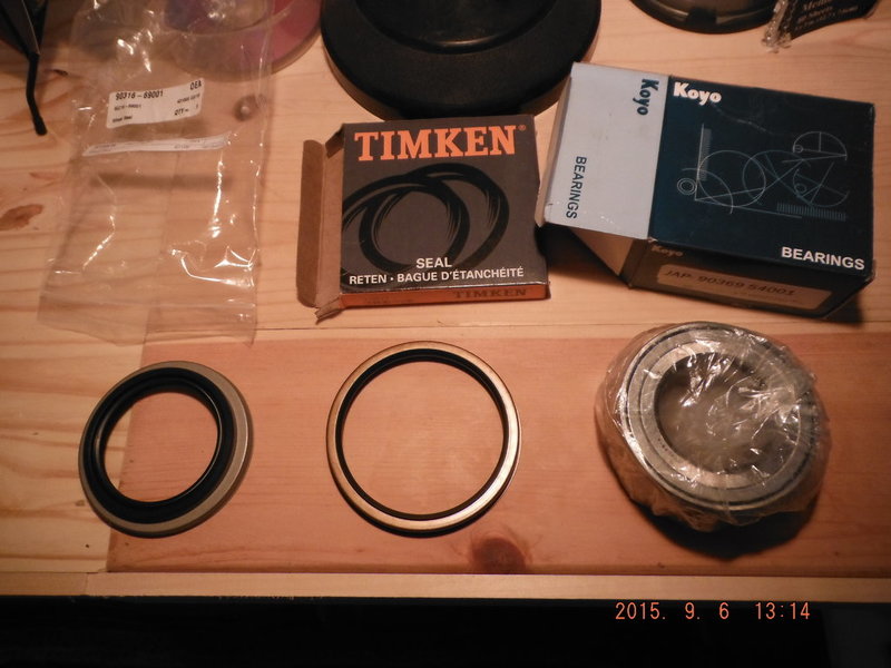

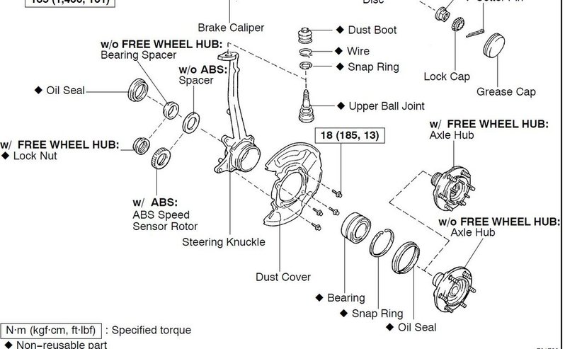

    I think I am ready to start the front wheel bearing replacement once the weather clears up :playball: I got all the parts that @BamaToy1997 recommended (see pic). I talked to one of my import parts guys, and he couldn't find the OEM control arm bushings. Do you think these Energy Suspension Bushings (see pic) are any good :notsure: I figured, once I am in there I might want to replace some of the other pieces of rubber if I see anything going bad...what else should I look for?

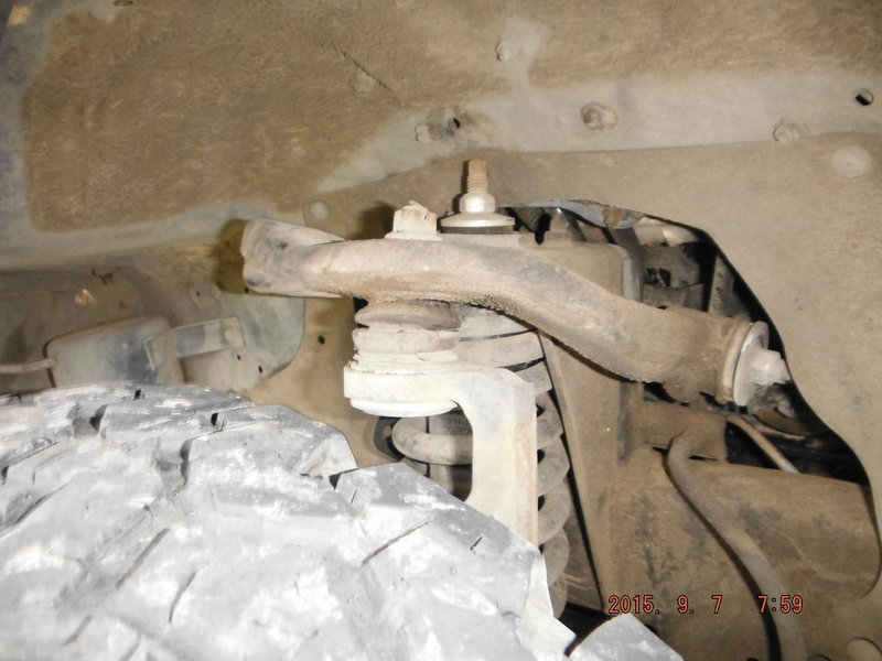

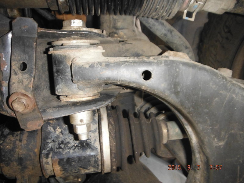

    Are you sure the control arm bushings are bad? Usually the bolts inside the bushings are froze. This prevents you from getting a quality alignment. The control arm bolts are weird. To adjust the camber, the bolts are turned to make the cams move, not the nuts.
    If the bolts are cross, you have a big job. The bolts need cut out with a thin disc, electric grinder. Of course the bolts will be destroyed. You will need bushings and bolts in this case.
    Because these frozen bolts are so common, the bushings and control arms are getting rare. Every frame replacement requires these parts. Aftermarket parts is your only choice. These are just fine.

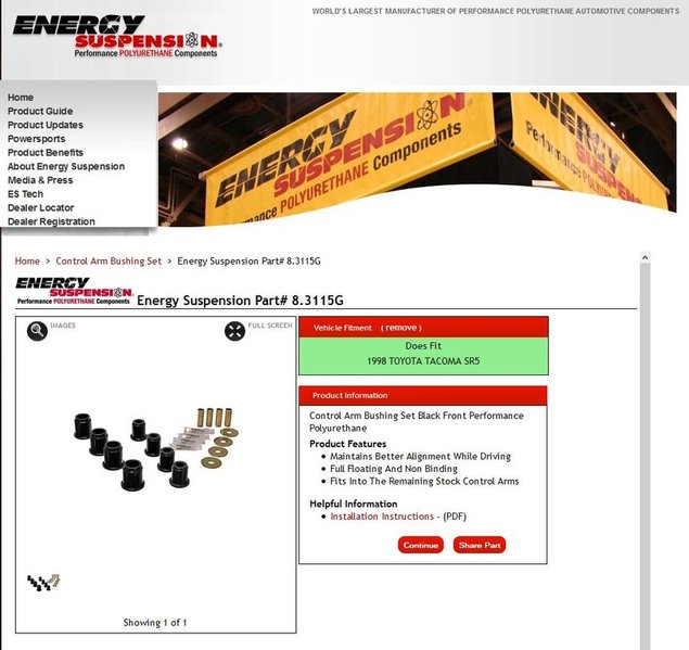

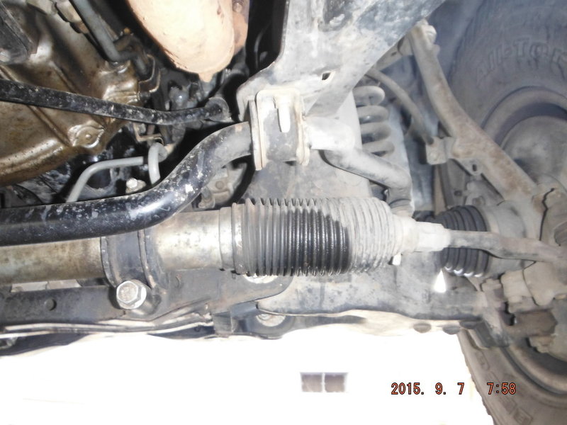

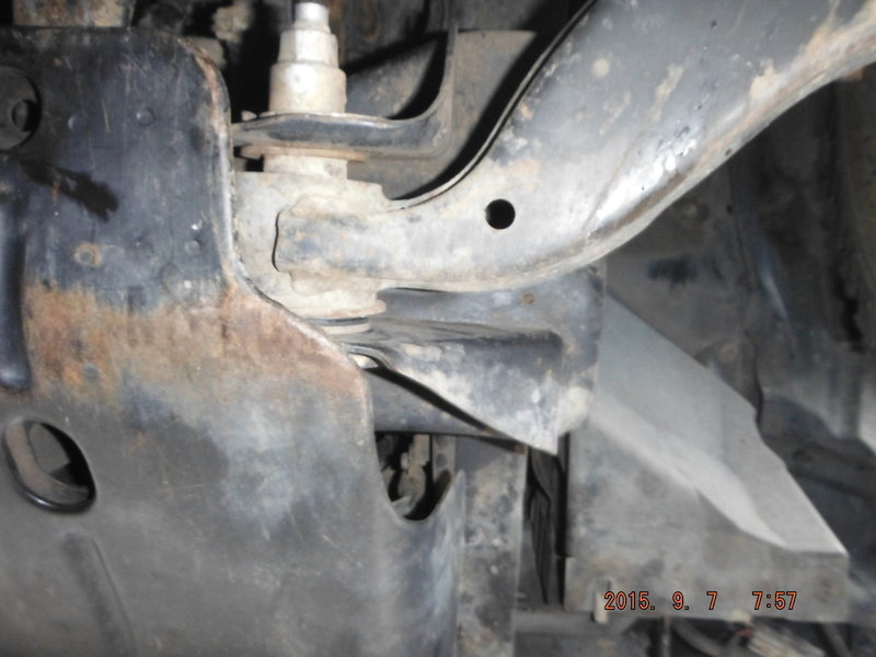

    It sounds like the control arm bushings are a real pain in the ass. I was thinking about doing the ball joints while I was in there, but I am not sure if we even need those. I took some pictures of whats going on under there. As far as I can tell everything looks okay, what do you think? It is hard to get a good shot of the control arm bushings. That steering boot bellow has not changed in months (wet w/o any dripping), and the fluid in the pump still looks good. I think its just the wheel bearing on the drivers side. I am hearing a whirring sound when driving, and I get a weird pulsing when I am braking (its not the rotors because I just replaced both pads and rotors a few weeks ago), and it seems like there is a drag when I let off the accelerator.
