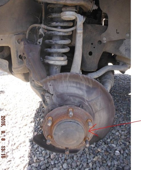

    Finally starting the drivers side wheel bearing. I jacked it up and got the tire off, and I noticed my rotor kind of just sits in place. I can move it back and forth a tiny bit. I took a little video of what I am talking about. Does this look normal to you guys? Is it just the lug nuts that keeps that rotor tight? Would this be the cause of my pulsation when doing hard braking? I appreciate any advice :bowdown:

    yep, its just the wheel and lug nuts that hold it on but I "think" there should be some very thin retaining washers so it doesn't come off unless you want it to.
    the 2wd rotors are bolted on but those are bolted on from the back side so changing rotors on a 2wd requires you pull off the hubs to do it

    @dollysdad Did you do some brake work recently? The one funny thing is that my rotors were stuck on the hubs pretty strong with corrosion from only being outside a couple of years. It's interesting that yours were so free considering the age of the truck.

    Normal to have slop when wheel is removed. Nothing holds rotor on except the lug nuts tightening down on the hub. Can't answer if that would cause odd noises.

    Yes, I recently did the brakes and rotors because I was getting bad brake pulsation. I am down to this part of the removal, it looks like a grease/dust cover (my manual only covers the T100 and 4 Runner at this point).
    Should my next move be to stick a chisel in the corner of it and pop it off? I am assuming at some point I will see the end of the drive axle :notsure:

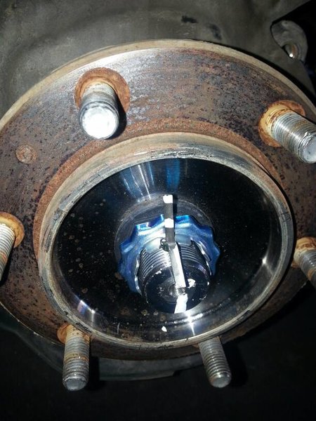

    This is what I did on my 2nd gen. It confused me as well:
    https://www.tacomaworld.com/threads/how-to-remove-hub-dust-caps.159958/

    those things piss me off :rofl:
    such a silly little part of the procedure to cause so much grief.
    I sprayed WD40 in the joint there and I swear it helped. That and I took the bench grinder to an old flathead to sharpen it and hit it with a rubber mallet working my way around.
    This is a second gen, but when you get it off it should look similar to this
