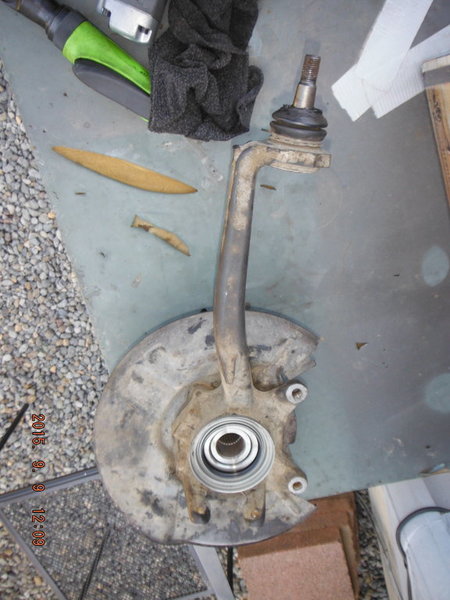

    A dealer in our area just said they can get us aftermarket uppers, "Meyley" brand. Anyone heard of this brand?
    A local parts store said they can get "Molly" brand aftermarket uppers. Anyone heard of that brand?
    But no dealers in our area can get the OEMs. They are on backorder, so we'd have to get the ones in Washington or go with aftermarket to do them now.

    Machine shop guy said the upper ball joint looks OK, he said we don't need to replace it. Sounds great to me - what do you guys think?
    They aren't terribly expensive, and the dealers made it kinda sound like they are discontinuing making the upper ball joints. Eric just thought they might need to be replaced because he said there was some grease leaking out. He said the shop guy said that's normal. Thoughts?

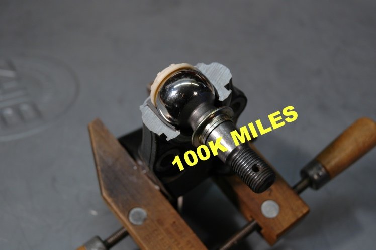

    These bushings most definitely fail in 1st gens. If you don't have a vibration in the front that goes away immediately when put into 4wd don't worry about it.
    More info here including a diagnosis/R+R vid. http://eastcoastgearsupply.com/i-14472912-toyota-7-5-clamshell-bushing.html
    Taco upper ball joints typically last at least twice as long as lowers.
    The FSM shows the technique for checking the lower BJ. They forget to mention that the bushings in the upper control arm put tension on the lower joint when the suspension is fully extended. This can mask play in the joint. It's best to use a pry bar between the LBJ and the very end of the lower control arm to check for play. The weight of a wheel/tire may or may not "squeeze" the joint together enough (against the resistance of the UCA bushings) with the suspension hanging down. I support the frame on stands, remove the wheel, jack up the lower arm to near ride height and then check for play. It's a fine line between good and bad, .020" max play or about the thickness of a match book cover. If you can eyeball any play it's time to replace.
    The 1st gen joints will pull completely apart if pushed too far and they frequently do because folks check them with the old "shake the tire" method and think they are still good.
    You don't want to screw up with LBJ's both service life and installation. look here https://www.google.com/search?q=tac...X&ved=0CB0QsARqFQoTCLzcsLOy6scCFZctiAodrPQG2g
    When replacing the LBJ or putting yours back on, the 4 bolts should be clean and have thread locking compound (Loctite) along with proper torque.
    Since you already have things apart, give the LBJ's a little flip flop and twist while they are still on the lower control arm. They should be relatively stiff (highly technical web jargon).

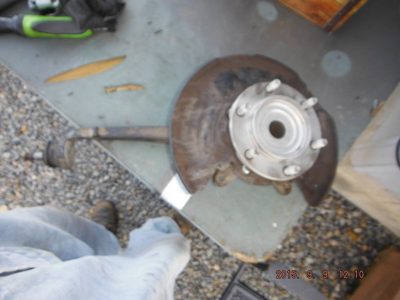

    If you already have new joints it should only be a few $ for the shop to do the R+R.

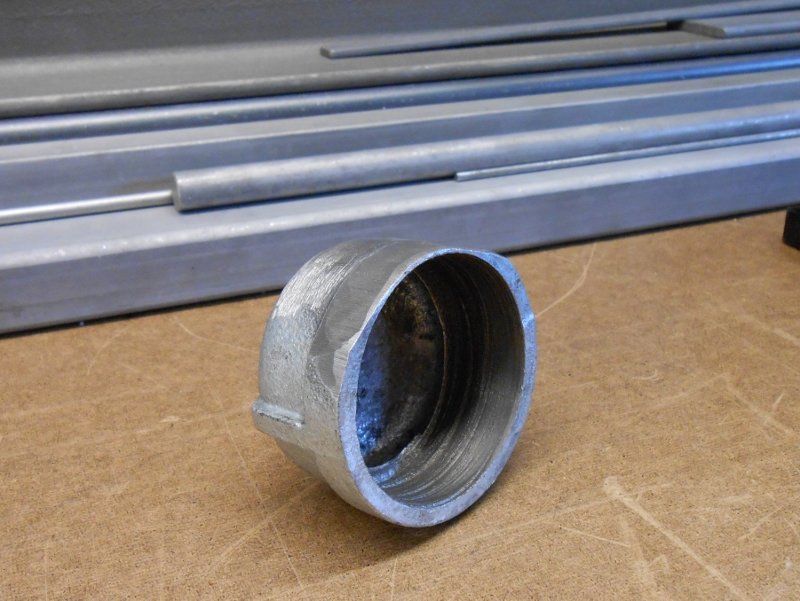

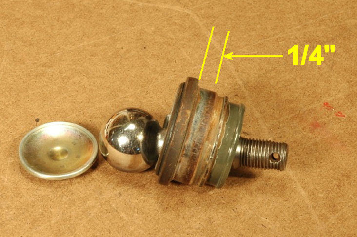

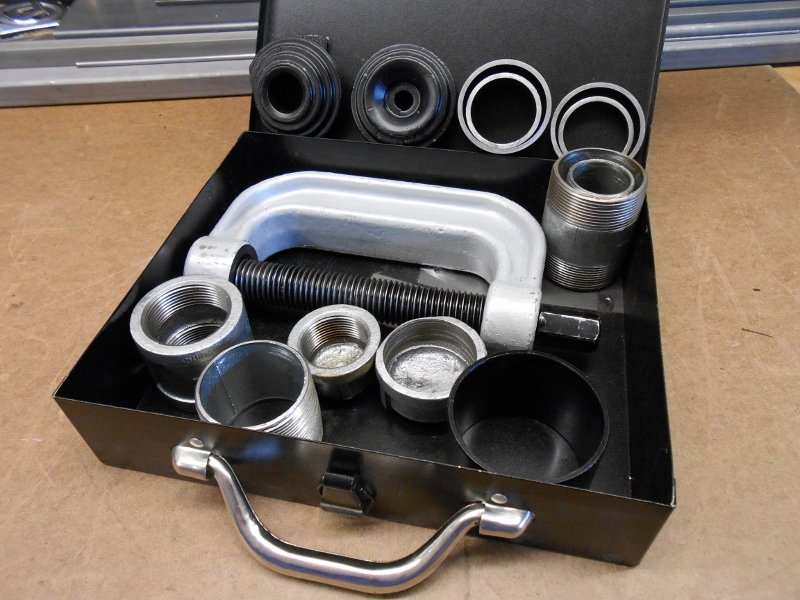

    If you go the DIY route there are a number of methods. With your spindle off the truck it will be more forgiving.
    The simplest way is with a "C-frame" ball joint press. These can be rented or loaned from some parts houses. They typically don't come with exactly the right adapters to fit the Taco uppers. I made up my own set just for the occasion. First is the receiving end.
    Folks get by jury rigging various pullers, the use what ya got theory. Another method for removal is to support the spindle (off the truck) with an appropriate piece of pipe. It needs an inner diameter "just" larger than the bottom end of the joint (pipe cap in first pic above). The pipe needs to be sitting on something good and solid like an anvil, preferably steel and massive. Now you can pound on the threaded end of the joint (after removing the snap ring). Smacked with enough authority one of 2 things will happen. Best case, the whole joint comes out into the pipe. Worst case the ball/stud portion forces the bottom cover off and pops thru leaving the carcass of the joint still in the spindle. The carcass can then be driven out with hammer blows. The upper end where the blows will land is a smaller diameter then the "press fit" portion so deformation from the hammer blows is no prob. Of course if you can scrounge up a piece of pipe that fits over the stud and against the housing/carcass, hammer blows can be applied to that.
    The "press fit" portion of the joint is only a band about a 1/4" wide.
    This one was removed with the destructOman, take no prisoners method.
    Installation is with the press or a hammer (carefully) driving against an appropriate adapter/piece of pipe that fits the outer bottom rim of the joint, don't traumatize the sheet metal cover seen in the left of the upper pic.
    Once the press fit area of the spindle is good and clean, with scotch brite or equivalent a smear of grease will allow the new joint to go in with much less effort than getting it out. Take care to drive/press the new one straight in.

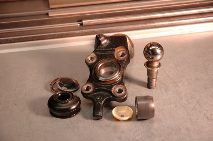

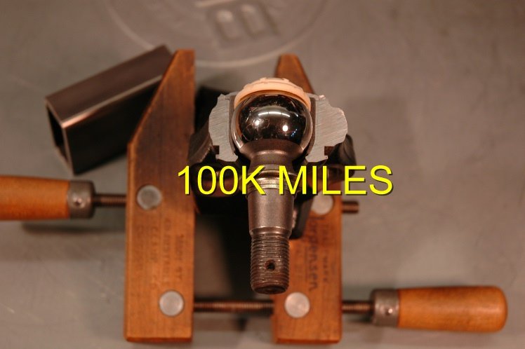

    That looks like it has "some" resistance. Here is the deal, that's just not a good conclusive test. When these fellows wear, play develops in an up and down direction, hence the method described in the FSM.
    Here is a shot of whats going on inside a 1st gen joint. The ball and socket is the wear area. Mostly the liner around the stud end of the ball. The ball is encased in a plasticish liner under pressure at the time of manufacture. This causes the drag you (should) feel as you move the joint. With out the force of the pry bar (FSM) you likely will not see the critical "up and down" play unless it's about to fall apart.
