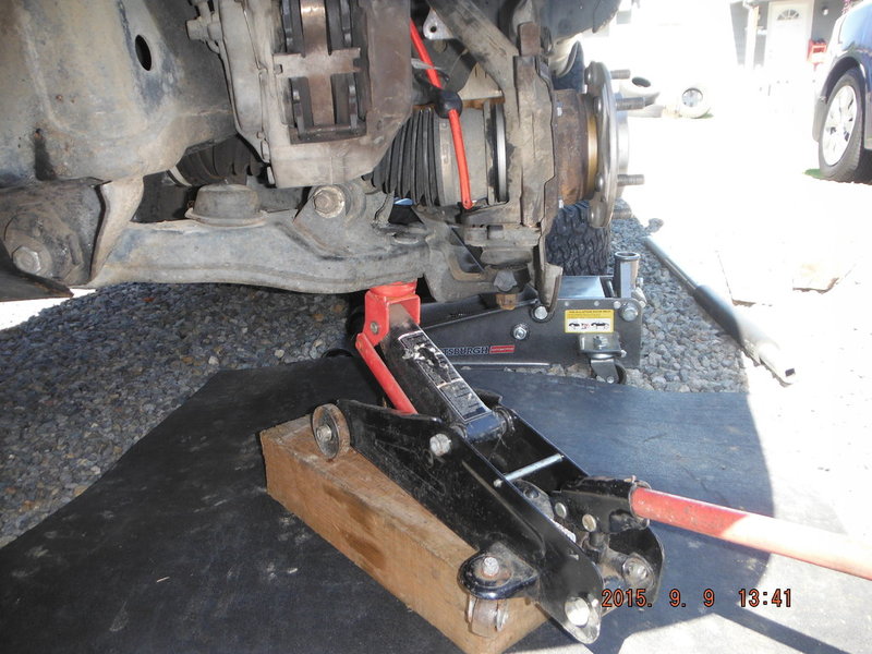

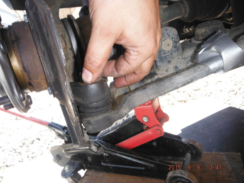

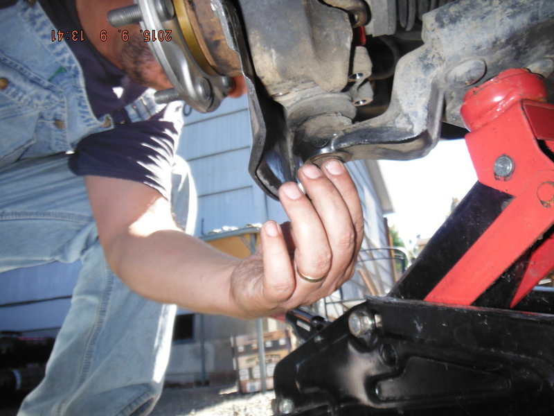

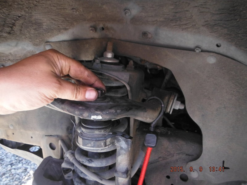

    While you guys have the upper control arm just hanging there, hoist it up and down to see the resistance I was talking about.
    You don't need a dial indicator to measure, .020" just isn't that much. Forget the "60lbs of force" as some exact number to follow. Just stick a pry bar or a good sized screwdriver between the head of one of the 4 ball joint bolts and the end of the lower arm and wiggle. Moderate hand force should be sufficient to move the joint if there is any play.
    With that, there is no reason you couldn't put her all back together, do the test and change them out at a few weeks down the road if needed. The catastrophic failures happen at a point well beyond the .020" wear. You don't need to remove a bunch of other stuff to R=R a LBJ.

    Go ahead and check em, that's a bunch of miles. See where this is going? Folks have gone that far on originals but many more have come apart long before. On line OEM's <$100 each.
    It's pretty much standard shop procedure to replace in pairs. Look back at the cut away pic. The forces involved are "pulling" on the stud of the ball. Before catastrophic failure can occur the liner would have to wear completely thru then the ball would have to wear (metal on metal) thru the heat treated steel. When it get's to be metal on metal it will feel rough.

    Eric already began putting things back together so we're proceeding with evaluating them as discussed earlier.

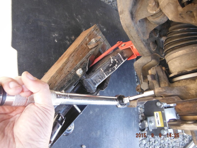

    We're checking torque specs and it looks like:
    • lower ball joint bolts are 59ft lbs
    • lower ball joint castle nut 103ft lbs
    • tie rod end castle nut 67ft lbs
    • still looking for torque specs on upper ball joint castle nut :notsure:

    80ft lbs.

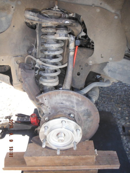

    I torqued the 4 lower ball joint bolts into place, then I did the tie rod end castle nut. Now I am trying to tighten the upper ball joint, and the post is just spinning inside the ball joint. Should I wrestle with it, or does this mean it needs to be replaced? Another video to demonstrate what I am talking about...

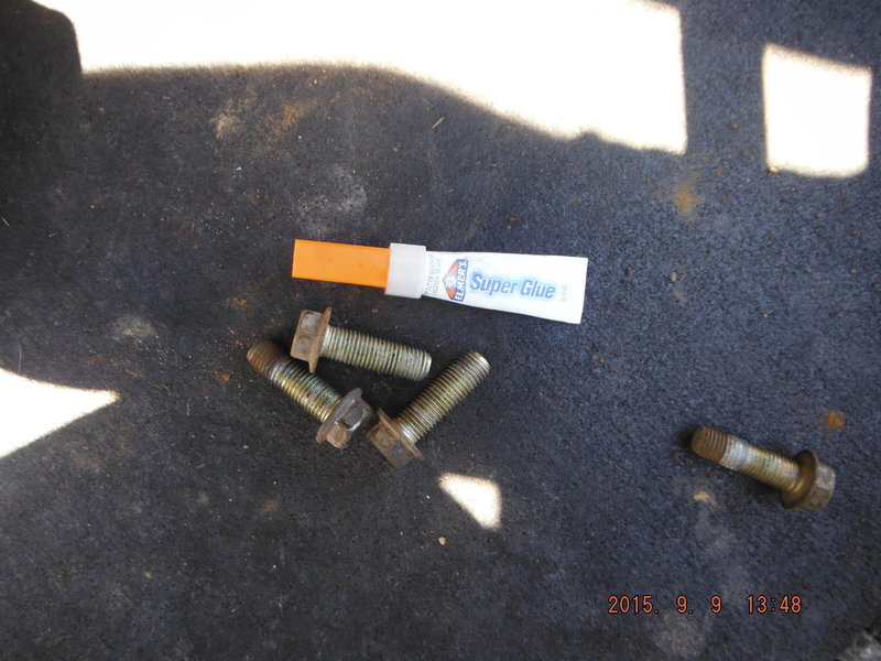

    I knew you would be asking this question on one of the joints. Try squeezing the the upper arm against the tapered shank of the joint to generate a little friction. It's the nature of that type of tapered fitting to lock together once it gets started. Sometimes a tap from below will wedge it in just enough.
    On the "Super Glue". I'm sure some shade tree says "that's all I use" and in reality true thread locking compound is super glue with some additives and solids, I say get the real thing.

    I yelled at him about the Super Glue. He didn't tell me he was planning to do that, I wonder why? :laugh: I saw it on the thread, then went out there and busted him :laugh: Can't do much but laugh about it now. :rolleyes:

    Eric just did the test per the FSM and thinks they are fine, but is open to replacing them anyway if I want to. I think I do. Bout ready to order from the Eparts place, but waiting to see if any of you have any good, bad, or ugly experiences ordering parts from them before I do it.......
