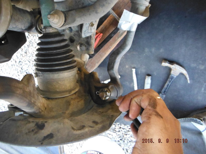

    you should have the tie rod disconnected to test it, there should be resistance to move on its own and stay where you put it when you let go of it.
    also as DP mentioned it can wear in the up and down movement too so lift up and push down and you should not feel it move at all.
    they are easy to replace so just wait till you know they are bad, if the FSM test leaves you unsure then they are fine

    It starts correctly now, thanks to the best dealer tech ever.
    He's got it all reassembled now. He took a bunch of photos and videos of checking it the way DP and the FSM described, so he'll be posting those soon.
    But ultimately I got pretty freaked out (imagine that ;)) thinking of how important those are and how old they are, plus now that I found somewhere to get them for $192 rather than $267, it's seeming much more worthwhile. Especially since he's a lot more confident about taking this stuff apart and putting it back together now! He just drove it around and said it's a lot quieter, can't hear the wheel bearing humming noise anymore. :cheers:
    Planning to order from that Camelback place that was suggested (unless we hear any reason not to from you guys), then just do the LBJs on a weekend sometime after they arrive. Whatcha guys think of that plan?

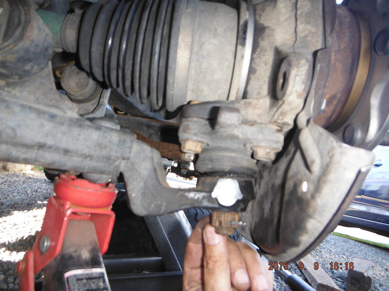

    I get most of my parts from Camelback. Most all the online discount Toyota dealers are close in price and many will price match. "Close" is to the point where shipping to your location makes the difference. Once you fit the "free shipping" point, Camelback is hard to beat. Some dealers will "stack" shipping. Example, 1 part has x$ shipping, 2 of the same part have 2x$ shipping and on and on. Camelback slips in a little "handling fee" but still usually work out cheapest to my door. They are also the closest to my location and there is a Southwest distribution warehouse right near them if the part is not in stock.
    All years of 1st gen Taco LBJ's are the same but there is a left and right, pay attention to that when ordering.
    I have bought at least a dozen LBJ's and they all came with new bolts, castle nut and cotter pin. In the last 2 years folks have occasionally received them with no fasteners. My thought is, it is dealer pilfering and then pawning off the remaining parts to the online market. I have no proof but it might be wise to ask about the hardware. They prefer to communicate by email so that can take a little time.

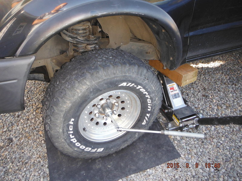

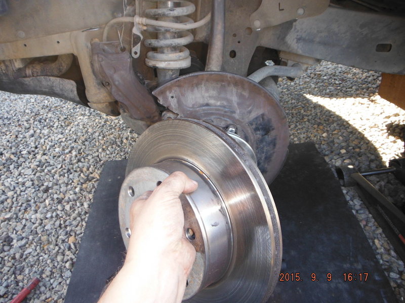

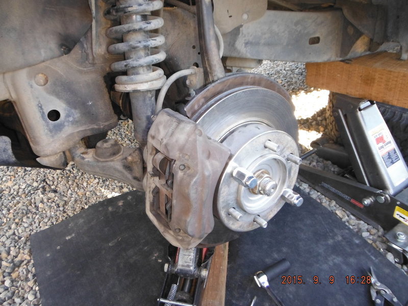

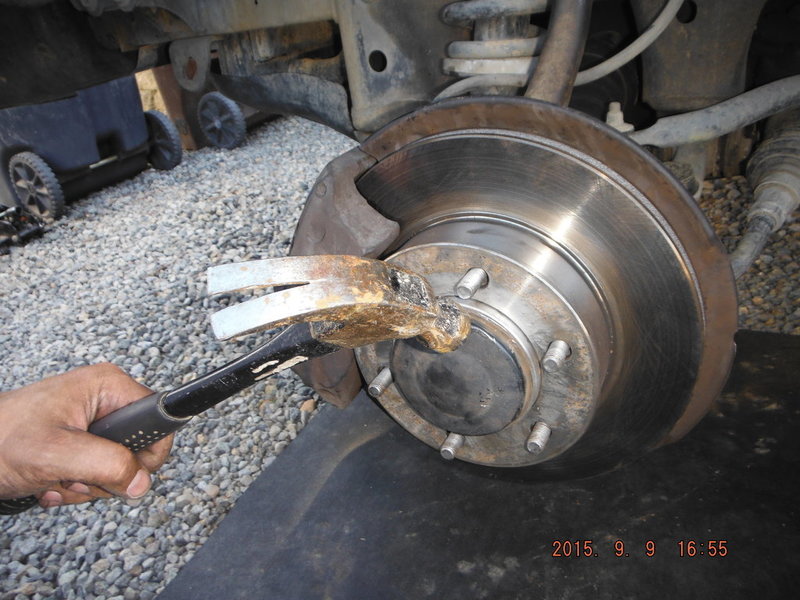

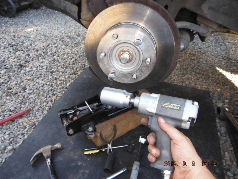

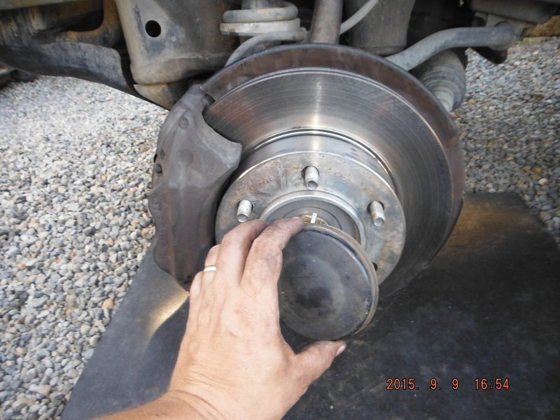

    65
    eric
    oregon
    1998 Toyota Tacoma TRD Off-Road

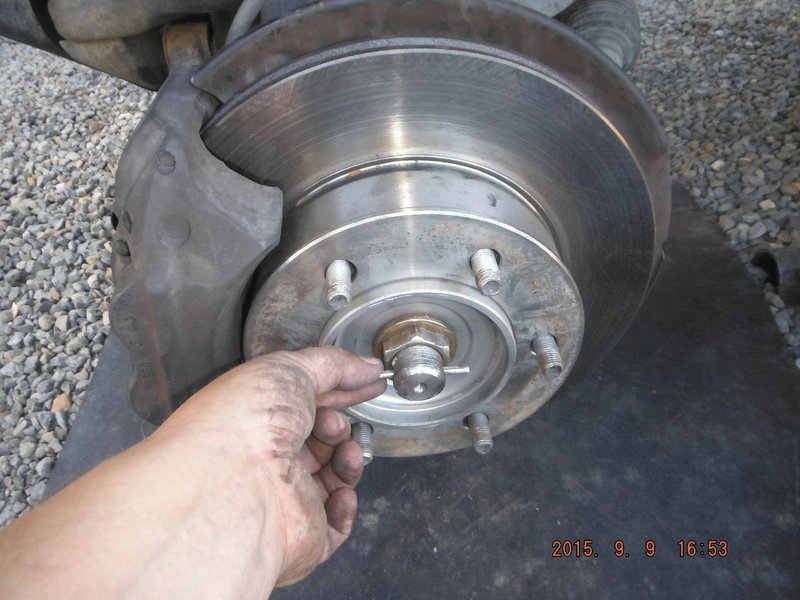

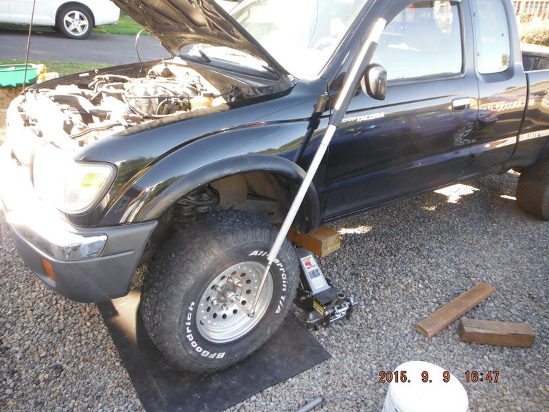

    finishing putting everything back together...

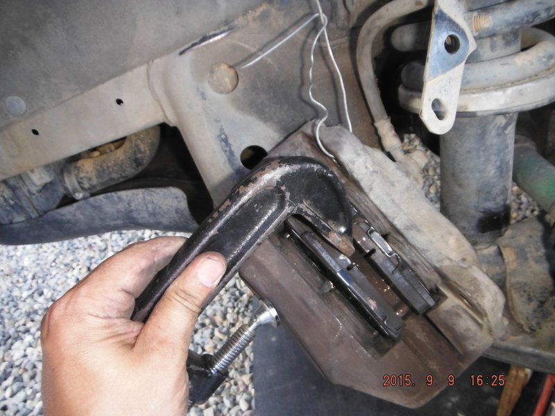

    eric, please DONT EVER DO THAT AGAIN with the c-clamp on the brake pad, you can crush the pads and cause it to crack, spider web, or outright shatter on you, it can fall apart soon after or even after some time.
    you ONLY want to put the c-clamp on the piston itself or on a piece of flat steel bar but NEVER use anything in direct contact with the pad like that putting uneven angled pressure in only one spot.
    I hope those were the old pads you were not reusing

    Yeah you wanna compress them caliper pistons before putting the pads on. I usually just spread em with a small pry bar...

    Should we put new brake pads on ya think?

    if he didn't bare down on them much he is probably ok, if he put some pressure on them then it would be wise not to risk it because even with no visible signs it may have done something to the pads bond to the metal backing, some have rivets holding them on but most are glued on with some type of ceramic or epoxy cement
