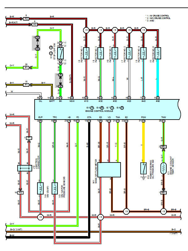

    Means to me that you need to replace the fuel pump. lol. Seriously tho, I am still mostly inclined to believe the fuel pump is bad. Opinion, yes, but based on what you have posted including the videos, and years of experience.
    Reposting this pic as it shows the circuit for your specific engine, and how the circuits are connected for operating the fuel pump.
    If you want to energize the fuel pump manually, you can connect a 20amp fused wire across the circuit opening relay. (Make sure you connect terminals 30 and 87) This will force the fuel pump on as long as the ignition switch is turned on. This should only be used for test purposes of course.

    All your symptoms have always fit a failing pump but and that is a big "but", your guy said he checked it with a gauge again and again. Should it be the fuel pump, it's not going to reflect well on him. There is nothing magic going on here.
    I still call the burnt wires a freak. That one fellow is the only case I have seen in specifically monitoring Toyota Truck forums since forums began nearly 20 years ago. No Tacoma owner goes into a fuel pump r+r with a new in-tank pump harness in hand might be a better way to put it. But anything is possible and opinions are opinions. Just watch, having said that, your harness will come up burnt.
    That diagram for fuel pump control /\ is a diagram of "theory of operation" not an actual wiring diagram. Below is an actual wiring diagram for a 99, or at least the pertinent half. I'm 99.9% positive it is the same for 98, at least for the fuel pump control circuits. Notice it's just a tad more detailed having terminal #'s, wire colors and shows numerous places for potential "circuitus interuptus".
    ENGCNT1_zps357dc814_f4b19757e9e6cfe0535c99df85ce5b4d6240e18c.jpgENGCNT1B_zps25486b85_6f4fe30af070f578ba1d70cdbdf598347a4024b9.jpg
    It sounds like your resolved to the dealer diagnostics as the next step. In your position I think it's a good idea. Make sure the service writer puts all your concerns on the ticket before you sign it. You don't want some vague "customer complains of poor starting when warm" BS. Don't accept any excuse like "they will know what to do". Make sure they are specifically checking the "start circuit" as it relates to start up fuel delivery and pump pressure in all situations along with the rest of the usual stuff. It might not be a bad idea to write/print up your desires and concerns to be stapled to the ticket. Remember, service writers are usually not techs. Edit, I see your already doing this.

    DP, thanks for the post! I gotta admit, the wiring diagram is over my head at the moment, but I suspect will be useful for us as we continue through this journey, as many times that's what has happened. You guys post some scary looking thing/suggest some thing to check that my initial reaction to is: [​IMG], but then I keep going back over and over all of your posts, and eventually they all wind up making sense to us and being helpful, even if just to better understand what the heck could be happening inside our truck's brain! Which allows me to ask better questions of the mechanics, and understand their answers soooooooooo much more than I would've otherwise. Thanks guys!
