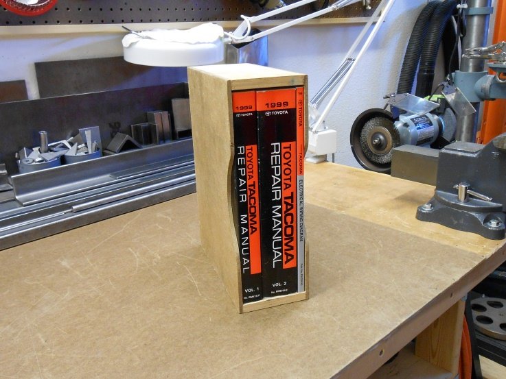

    Before the internet became all powerful, I was able to buy specific pages of the FSM from the dealer. They would charge me a dollar a page. Maybe give your local dealer a call and see if they would do that for you.

    Thanks K. I did call the dealer this morning, and they said they can get Volume I for $99 but can't get Volume II, and also can't tell me what's in each volume. Super helpful.
    BUT, they did tell me about this site: https://techinfo.toyota.com/techInf...https://techinfo.snapon.com/TIS/Register.aspx
    where you pay a subscription fee to have access to FSM's of various levels of complexity for a certain period of time. We may do this, husband is looking into it.......
