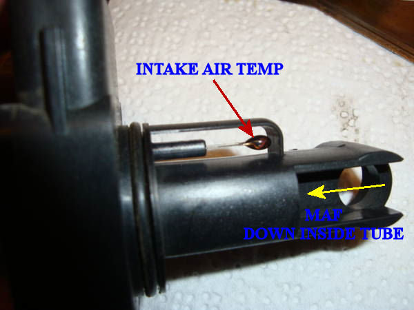

    EDIT #3: Kigmob posted this a while back: "My 97 has the tube like MAF and I just clean it by removing it and spraying MAF cleaner into the center piece (this is where the sensing element is located) then let it dry for 20-30 minutes."
    Would that method get the IAT sensor clean as well? Just went back and reread DPs recent post about this: "many folks pull the thing, look at it and clean the apparent sensor. This ends up being just the IAT as the MAF portion is sort of hidden."

    OP, you may have already found it but info on the MAF should be in "5VZ-FE SFI section SF. You will only find electrical tests, Toyota does not approve of cleaning the MAF, just replacing. Countless folks clean them with good results all the time. I clean mine just as PM at every couple of air filter changes. Remember, just a blast from the can of cleaner. No touchy the element with anything.
    Closed loop refers to the ECM entering a mode where it uses actual running air fuel ratio data feedback in it's calculations. It does this after things are all warmed up. During the warm up period it takes a simpler approach, kinda like we do when we wake up from a nights sleep.
    Edit, this is what the 99 MAF looks like. Your housing may be different but the actual MAF element ant IAT "bulb" should be the same.
