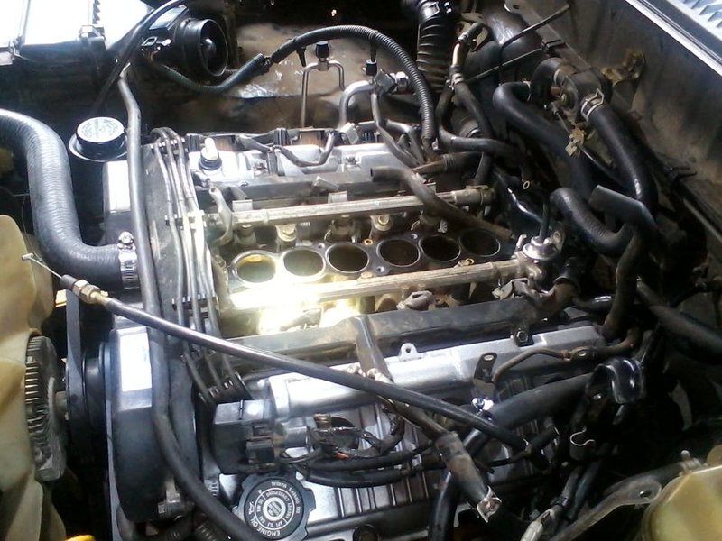

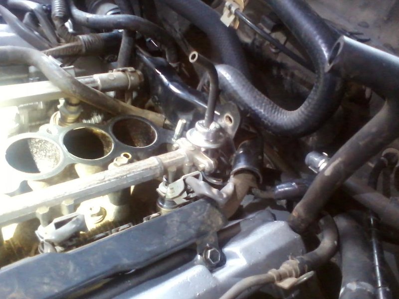

    Here's a couple of photos we took when we were over there Sunday, and he had the FPR exposed. The third pic is from this morning, when we dropped the injectors off, and saw that our awesome mechanic had all that stuff taken off under the steering wheel with that fancy Snap On tool hooked up to the DLC3. I assume he had that stuff taken off to expose where you'd check the circuit stuff?

    Our mechanic was disgusted to see how filthy dirty it'd been left inside those black holes in the middle between the two fuel rails. I forgot what those holes are called? Those would have been original to our truck and swapped over, right (not part of the new engine)? And there was dirt/debris all around that area that he cleaned up for us.
    EDIT: Lower intake manifold plenum. Thank you google!
