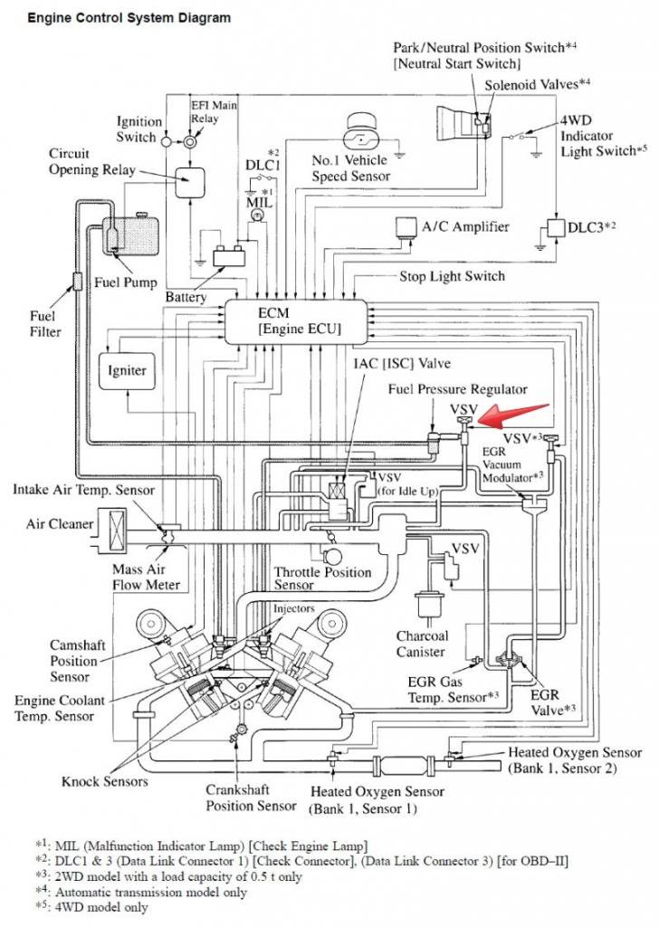

    Just got through reading pretty much all the posts,,, whewwww, cross eyed old man now.
    Question for the real toyota mech. on this post,,, does her 98 v6 have a vsv on the fpr? I know on my 95 4cyl in the fsm, it has a specific paragraph for "hot start",,, and I know ya'll probably know this but it talks about when the engine reaches a certain temp (hot) the vsv is energized and it kicks the fpr in the hiney and it boost the fuel pressure for this issue, I pursued this some this past summer here in Houston on mine, one time just checking the problem, I unpluged the ecm connection on top of the vsv and took 12 volts straight to the vsv and it started right up,,,, just saying, kinda left it there for the time being. I ran into a problem that I won't get into now, to long winded, but I'll come back and ask my question later to some of you mechanics if you don't mind.

    Thanks pulldo! Rereading your post a few times now to make sure I get exactly what you're saying, but in the meantime I was eager to say thank you for reading, sorry for the cross eyes! I owe ya one man!
    I noticed something the other day in our FSM about that VSV thing and wondered if it could have something to do with our issue. Will read a bit on it and try to put together how to present this to our mechanic......thanks again!

    Good eye!
    Is this (yours) a 98 FSM and are there any footnotes such as "applies to 2wd" or "auto trans only"? I am curious about exactly when this feature was discontinued.
    The 95 V6 does have it (including the T-100), I just don't know when it went away. I always thought it coincided with the early presence of the V6 EGR system, but not 100% on that. I know 99 up V6 does not have the EGR or FPR VSV.
    From the 3 pics you put up the other day I don't see any EGR system or the FPR VSV on yours.
    Here is a diagram. It shows both systems, not sure if they were always used together or not, on the early trucks.
