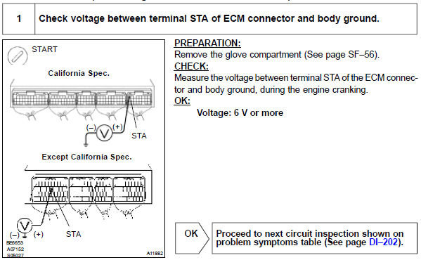

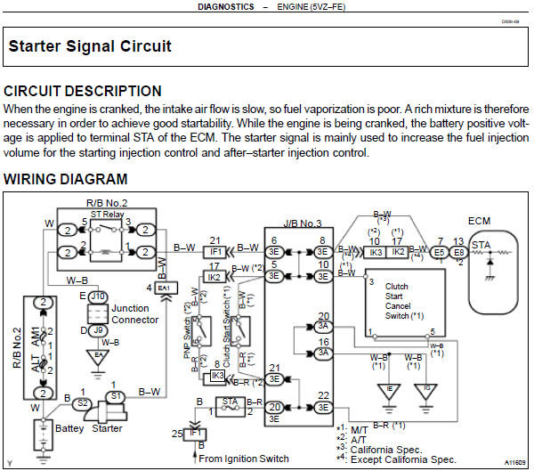

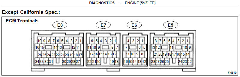

    Still waiting to hear from him, but reviewing this starter stuff again in the meantime....

    Sorry people, no new info, it's just easier to bring stuff to the "front" of the thread when I'm reviewing a topic.....

    http://www.yotatech.com/f115/no-injector-pulse-191125/
    As usual, no conclusion posted (I will not do that to my faithful cheering committee, or future people reading this and suffering the same issue!), but certainly seems like some of the stuff on this thread could apply to our situation....
