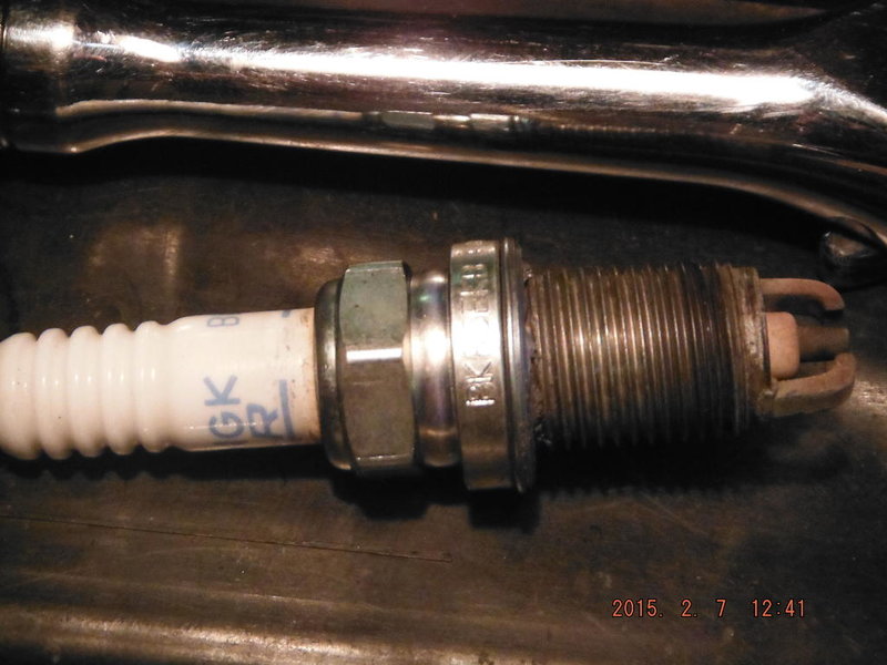

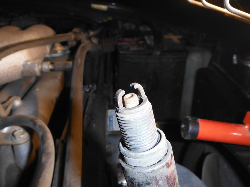

    OK, looks like false alarm on the plugs - he just pulled another one and it looks new/good....but that 1st one he pulled from #3 was totally carbon tracked, JUST LIKE 2007, JUST LIKE HOLE IN PISTON EVENT - which supports the theory we've had all along - IT'S THE COIL PACK!!!! HOLY CRAP WE MAY HAVE OUR TRUCK FIXED FINALLY IN THE NEXT FEW HOURS YOU GUYS!!! MIGHT ONLY NEED ONE PLUG!!!

    you guys stay tuned, i really really think this is it!!! it all adds up! I know there have been a bazillion false alarms, but i really think this is it!! getting the champagne chilled, gonna walk back over and give husband the plugs, then ready to hit send on rock auto for 2 more denso coil packs if it starts correctly after this!
    #5 was carbon tracked too! not as bad as #3, but it really really looks like it's the coil packs! we only have the one we bought right now, that aftermarket one, so we'll put that at #3 then grease the #5 real good/careful again, but i'd think we'd see a significant improvement in all symptoms if this is it, even if #5's coil pack is barely hanging in there, especially if greased well....then new ones to arrive from rock auto very soon

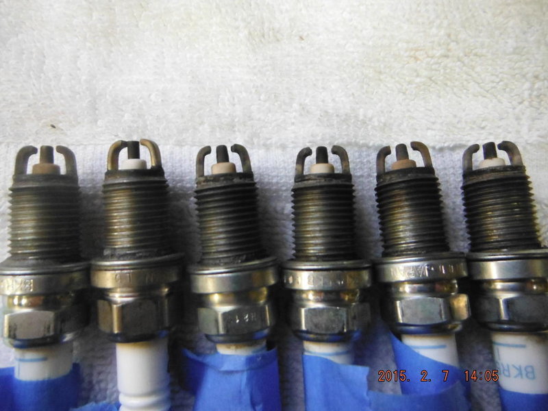

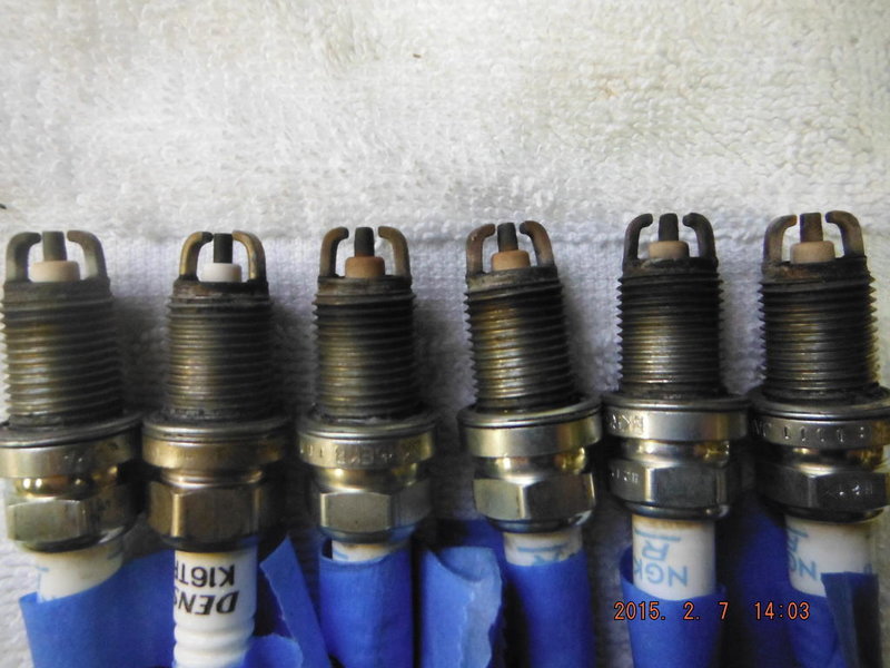

    here's some shots of the plugs for your viewing pleasure.....who can guess which pic is of a plug from the old engine? :D
    current plugs we just pulled are laid out from L to R in order of 1-6, one photo is one side of them, other photo is other side of them
    other photo is close up of #3 current plug
    it's weird, none look familiar to us so definitely they were all replaced by engine mechanic, but one is denso and other 5 are NKG???????? WTF? wondering if they put used plugs in or something, for the ones that look bad? #2 (the only denso) is the only one that looks pristine to me.....what do you guys think?

    Oddly enough, its pretty common to find 2 different brands of plugs in the 3.4. I don't remember why its done, but is noted from time to time. Do quick search on the TW site and you will find many reporting this.

    When toyota sold denso way back when they signed a contract with ngk to supply their plugs. Then when Toyota bought denso back they started using both suppliers to avoid paying a contract cancellation fee. To this day 1GF-RE engines have ngk plugs on one bank of the engine and denso plugs on the other.

    So...can we sermise that the engine builder used original plugs if Jen has 2 different brands? I know if I was replacing plugs, I won't be buying 2 different brands.
    I'm just wondering out loud.
