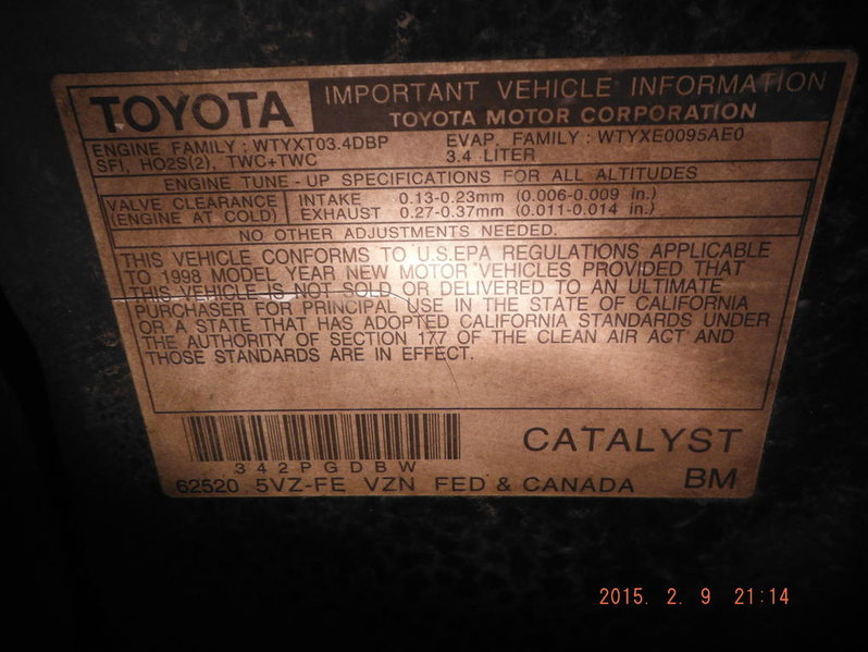

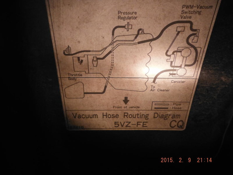

    Whoa! Husband just showed me what he meant about the hood, and it doesn't sit flush with the rest of the body of the truck anymore when closed! And it doesn't pop up at all - you literally have to wiggle your fingers under just to pop the latch! Not normal or even close for sure. Hmm. Definitely wasn't like this before. Don't know if it's something or not, but it is NOT normal.
    Husband Edit:
    We also discovered a couple of labels under the hood (in addition to a bunch of "nummi" labels with our VIN printed on them (CA USA Toyota/Ford experiment manufacturing plant)). If I were to guess, one label is saying we don't have an EGR, and the other is telling us how our EVAP is routed. I was wondering if there was a simple pinch test that could tel us if the EVAP system was working proper? Thank you for all of your help.
  16. Feb 9, 2015 at 8:51 PM
    #1656
    Sterdog
    Sterdog Offline
    Sep 26, 2013
    #113290
    18,435
    I am Groot
    People's Democratic Republic of Canuckistan
    15 FoST
    It was a GM and Toyota plant. GM wanted to learn about Japanese manufacturing practices and Toyota wanted to gain experience with American workers. Hence NUMMI was born.
    Ford wanted nothing to do with a plant in CA, for many of the same reasons why Tesla is now looking to move production out of the old NUMMI plant and into Nevada.
    As for the rest it may as well be in Japanese. I hate auto codes. The diagram is nice I guess if you have a vac leak and want to follow to hoses. Sorry :(
