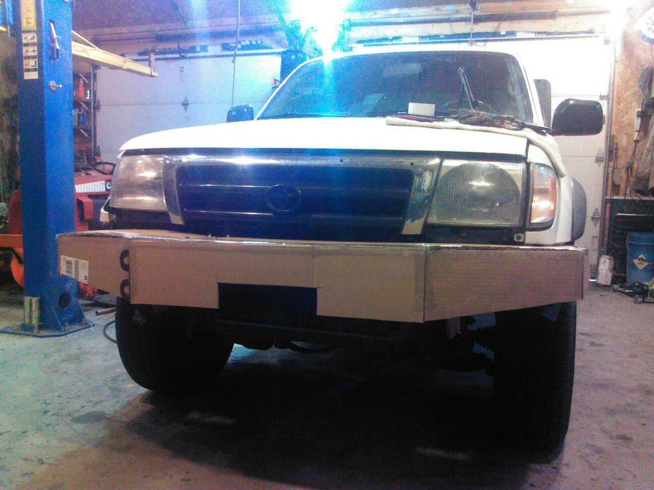

    quick opinions needed. this is what I'm going after.
  7. Feb 14, 2015 at 9:13 AM
    #1867
    koditten
    koditten Well-Known Member
    Sep 8, 2013
    #112077
    19,617
    Kirk
    Central Michigan
    04 trd x-cab 4 x 4 3.4l
    Reserected from the dead.
    This what I got mocked up. I need to know if my dimensions look similar to the picture of an actual ARB bumper. I don't have an actual bumper to measure. From were I'm sitting it looks pretty close, which is fine. I can't get in trouble for copywriter issues if it a little different.
    I know I'm thread jacking...and I don't care.:cool::D:)

    [​IMG] Been wanting to find a chance to use this emoticon from day one, finally got one, thanks!!
    Looks good K, nice work! :)

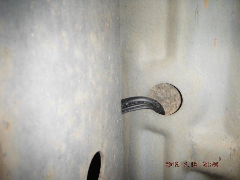

    good god that's hack job work :eek:, soon as you drove in the rain your carpet and floor would be soaked from underneath and the floor mats would have mold and mushrooms growing under it :rolleyes:
    the good news is it looks like they just popped out a body plug so you should be able to get another one and just pop it back in the hole to seal it up.
