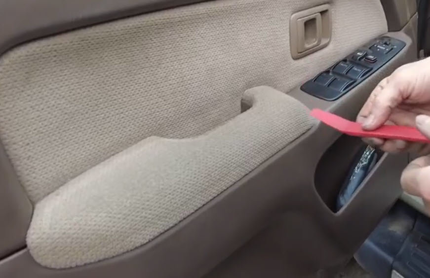

    My truck has power windows and power door locks. I'm following Timmy's video on removing the door panel so I can replace the door check. I have the plastic panel tools. I wedged them near the front of the top part of the armrest and the longer part of the armrest. No matter how hard I pry I cannot get the clips in the top part to come out of the longer part. Same problem with the rear of the top part. I'm afraid that if I use all of my strength I will either break the plastic panel tools or damage the plastic parts inside the armrest.
    How shall I proceed?

    You're gonna have to yank on it. Nothing to it but to do it. I'd try and make sure the plastic isn't freezing so its not so stiff. When you pry make sure you aren't pulling against the fabric or you'll rip the glue off holding the fabric to the plastic.

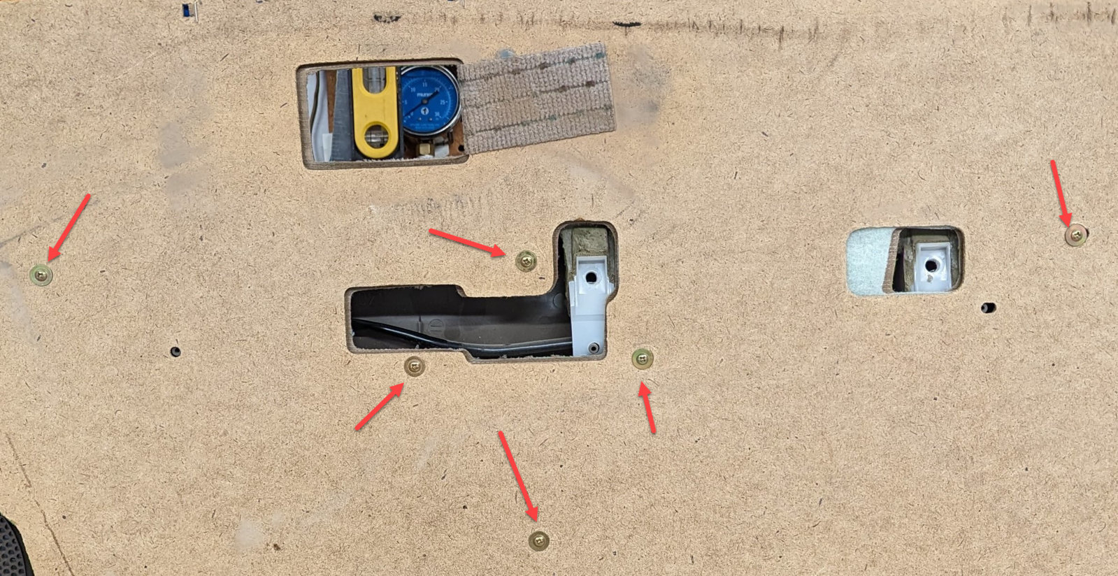

    As it went, I gave up trying to separate the two parts of the armrestg. When I finally got the panel off the door, I saw that the entire length of the armrest is fastened to the panel through the back by six Philips screws as shown below:
    For those of you who have a 1998 with a panel like mine, here's what I did different than what Timmy did (I think he was working on a Gen 3 Forerunner).
    I had already removed the two Philips screws that were underneath the two plastic caps in the armrest. I removed the screw that holds the inner door handle in place. Had a hard time getting the handle out. Didn't want to chance breaking the plastic clip that holds the inner door rod to the handle so I just left it connected. I also removed the power switch panel that's on the front of the armrest.
    Next, I went around the bottom and sides of the panel and managed to pry most of the plastic door pins loose (I did manage to break two though ). Guess I'll hafta borrow the War Department's car tomorrow to pickup a dozen.
    Then I powered the window all the way down (prolly didn't really have to do that), removed the top plastic sill (or whatever it's called - where the door lock button sticks out through the top of it) and that gave me access to two more door pins (one at each upper corner of the panel) which I removed. After removing the speaker and feeding the inner door handle through the panel I was done.
