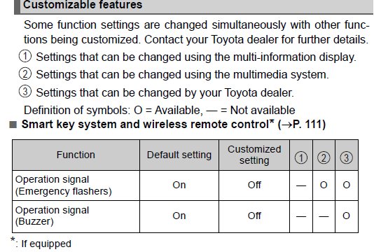

    Hello, I want to turn on the setting-the-alarm beep, if the is no background noise I can hear the locks enable. The ambers will blink but sometimes they are hard to see, so a nice crisp beep to confirm arming the alarm would be preferable.
    I tried the procedure in this video, which is for either enabling or disabling the beep. Unfortunately, it does no work for my 2019 Tacoma.
    I gather that many people want to dis-able the beep, but I would appreciate any help for enabling the beep.

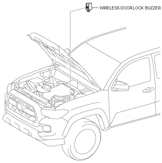

    Does your Tacoma even have the buzzer? (behind the Driver's side Headlamp assembly)

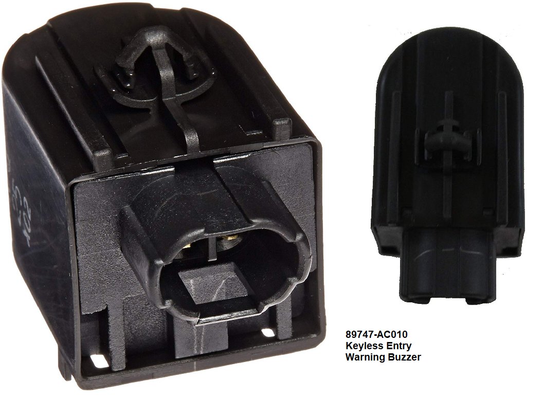

    Not seeing anything that I would recognize as a buzzer....
  11. Aug 27, 2021 at 12:39 PM
    Skydvrr
    Skydvrr IG: @kalopsianick
    Sep 13, 2017
    #229889
    12,652
    Nick
    YMH
    Black '17 OR
    Yep. Grey plug I think.

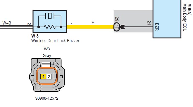

    Yes, that's the buzzer connector. You could place an LED in the pins and press the remote lock, it should illuminate. Yellow is (+)

    OP, were you able to test the output on the connector?
  17. Aug 27, 2021 at 4:46 PM
    #17
    tnthomas
    tnthomas [OP] Active Member
    Aug 27, 2021
    #375434
    26
    2019 Tacoma
    I did not, but I'm glad you mentioned it, as I should verify that connector's function. I don't have an LED handy, maybe I can use my Greenlee meter to read it. I'll go see...

    DO you have alligator clips for the probes tips? You could pinch a paper click to them, then touch the connector leads.

    Good idea, I'll see if a small paperclip will fit in the connector; I can hold the leads on them and have my wife activate the remote.

    They should be male tips inside the connector. Careful not to bend them.
