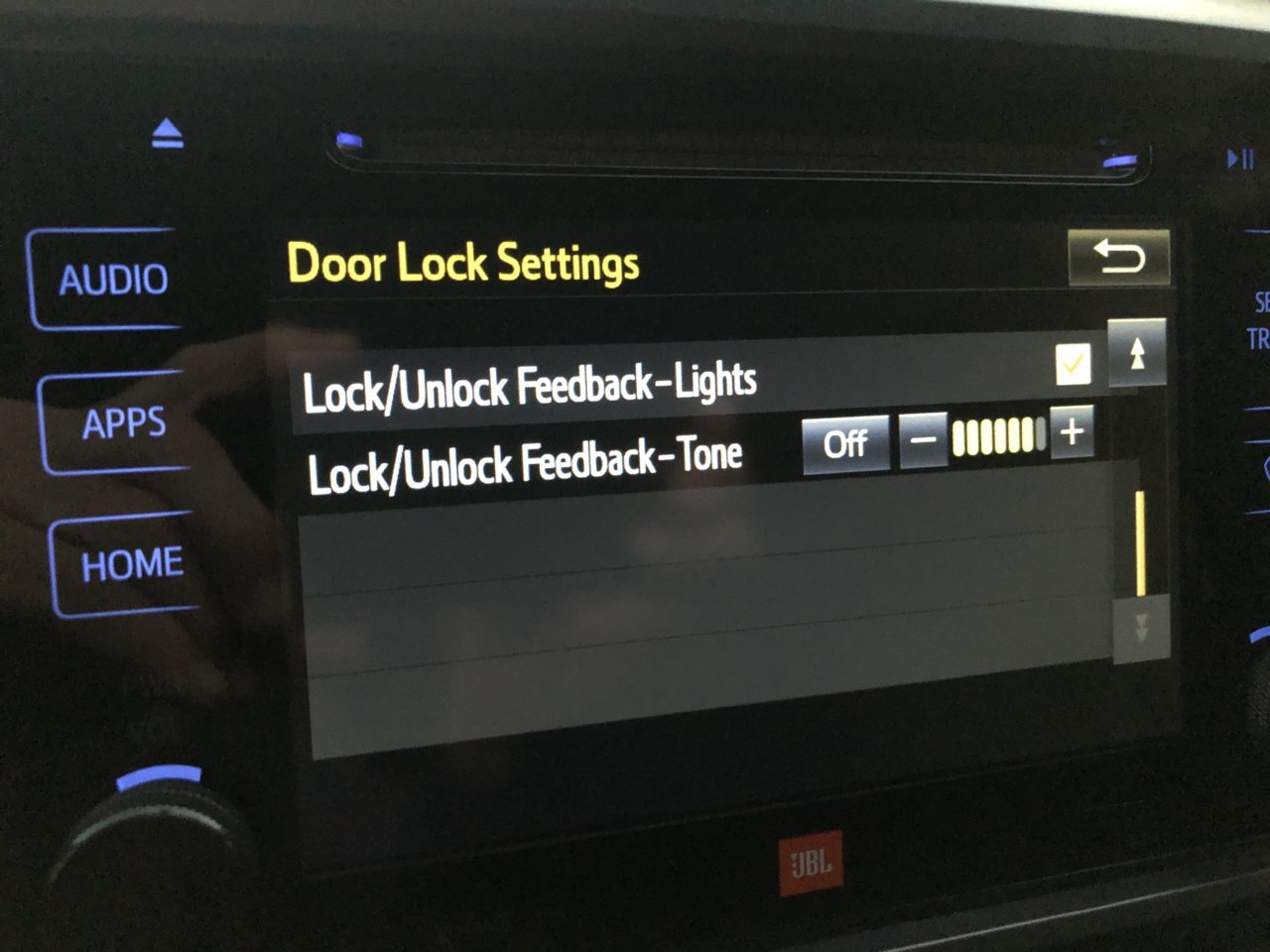

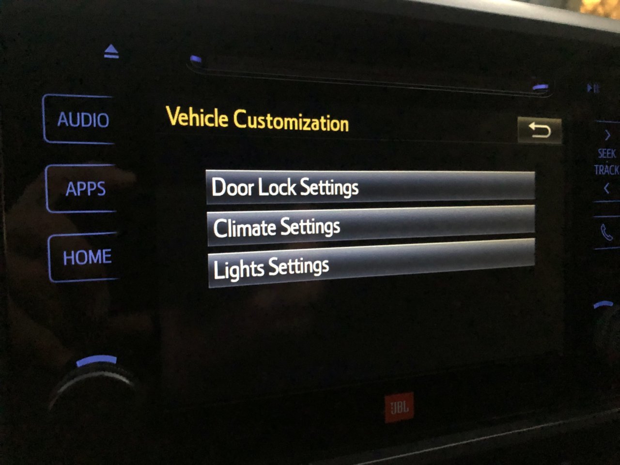

    The head unit is the radio....you can set lock confirmation tone volume though settings app.....unless I’m missing something or the 18 is different
    EB851C97-AF3F-483B-97AC-1124B20C382C.jpg FFFA5ABF-03E7-45A7-AF1F-A638A2D386B1.jpg

    My display is different for what you have. There is a "beep" checkbox but checking or unchecking has no effect on the door lock audible.
